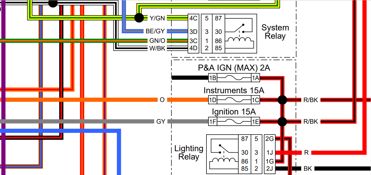

The stator plugs into volt reg. So technically they never touched related wiring. I am not sure which fuse this is off. Anything else out?
Look at schematic and see where it gets power from.

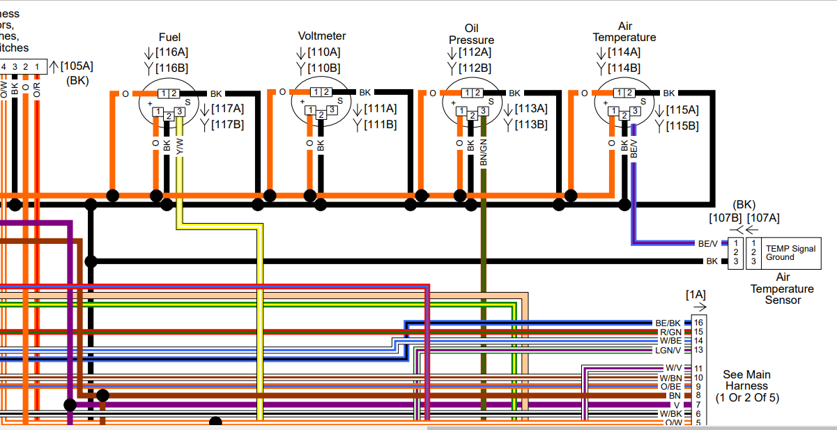

Anyway Ranger gave good advice. The power comes from the Instrument fuse and daisy chains to all instrument lights So like he said, Bulb or possibly wire problem.
If you're handy you might pop the fairing off and change it yourself. In the schematic the bulbs are 1-2
