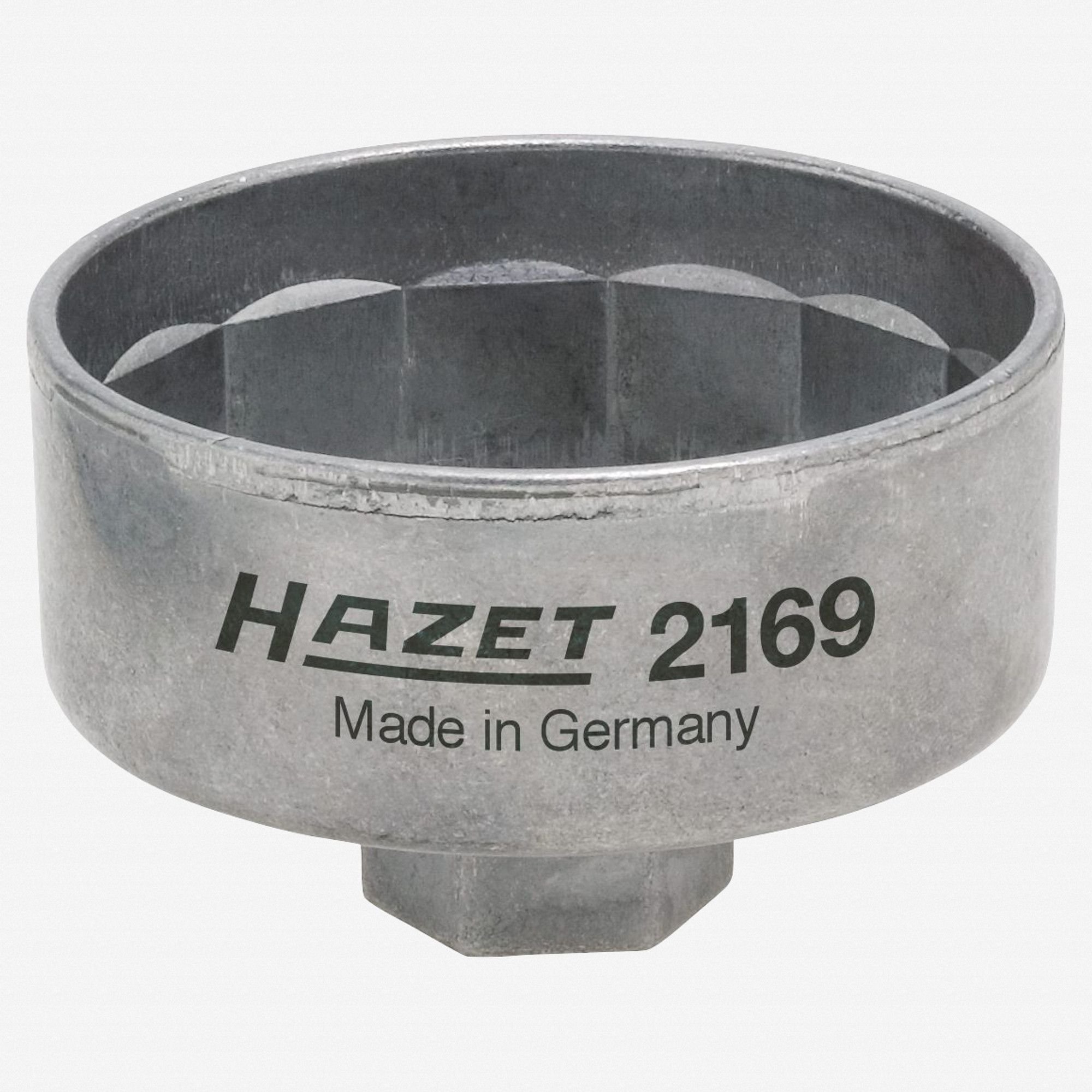

Hazet oil filter sockets are pricey but fit tight and are worth it, mine has never failed to loosen the most stubborn overtightened filter. My Hazet 2169 has fit many bikes and cars I've owned including my Sportster...
Thanks mate. If the one that I have ordered doesn't work, even with the self tappers - once I finally get the filter off, I'll go for a tool like this for the future.

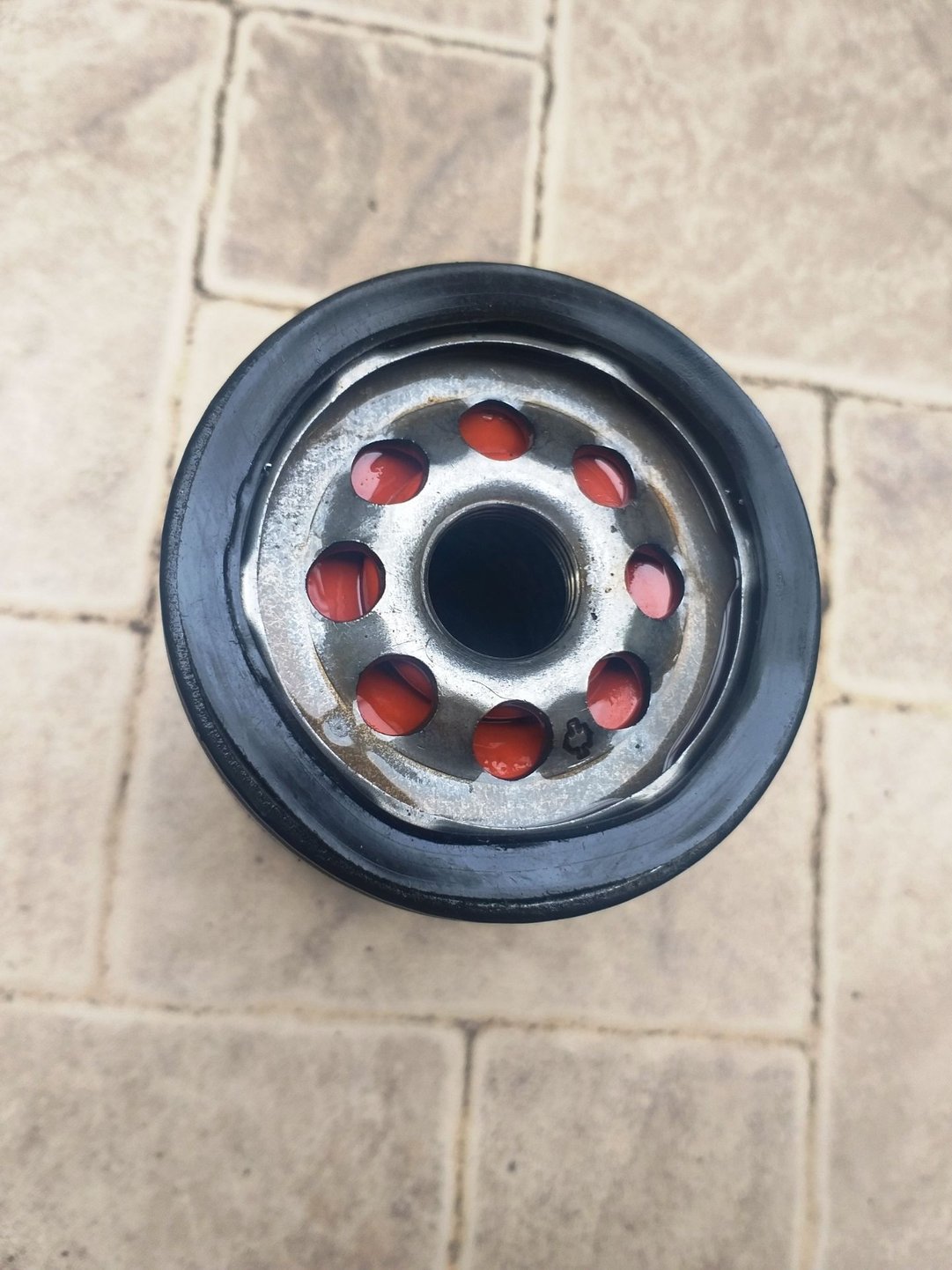

Update guys: The cup style filter wrench arrived today.
They sent a 76mm which was too loose and kept slipping.
So, to prevent rounding off the end of the filter, I got a strip of sheet metal and made a shim to make the wrench tight on the filter.
Then did as others suggested, @Schex , I drilled two holes and screwed a couple of self tapping screws through the cup and into the filter head. After a little leverage with two 12" extension bars, Voile! off that sucker came.
I still have the strap type recommended by @eighteight and the tool recommended by @CoolBreeze3646 on order for all future oil filter nightmare scenarios. Thanks to all for the positive feedback.
Here's a pic of the old filter - you can see how tight the monkey had installed it by how deformed the seal is.
