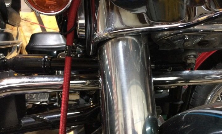

Here's the damper on my '96 Electra Glide, a factory sidecar rig that's made this way. There are sidecar damper kits with clamp on ends available, might take some research to find one that fit your combination. It would make a difference. Putting on a trike triple tree and forks that extend the front end rake would make steering easier, but that's pricey. You might find this thread interesting:
