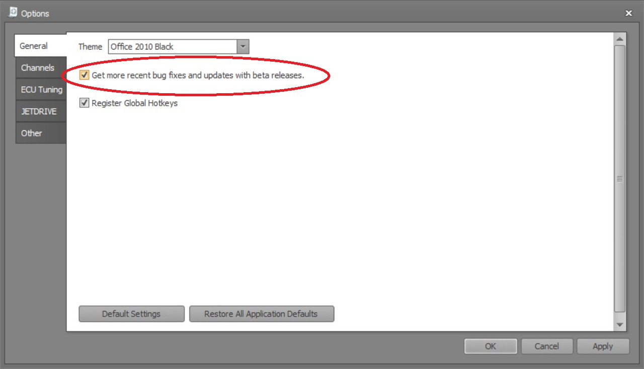

ive tried opening 2017 and 2019 strategies and neither opened. up to date Power Core.
In Power Core go to Tools>Options>General and make sure you have the box checked for the latest beta releases, this will include updates between full software release versions

Likes: 13
From: Kingston, NH
awesome, thanks!

so i checked and i do have the options for beta sw checked and still no go.
