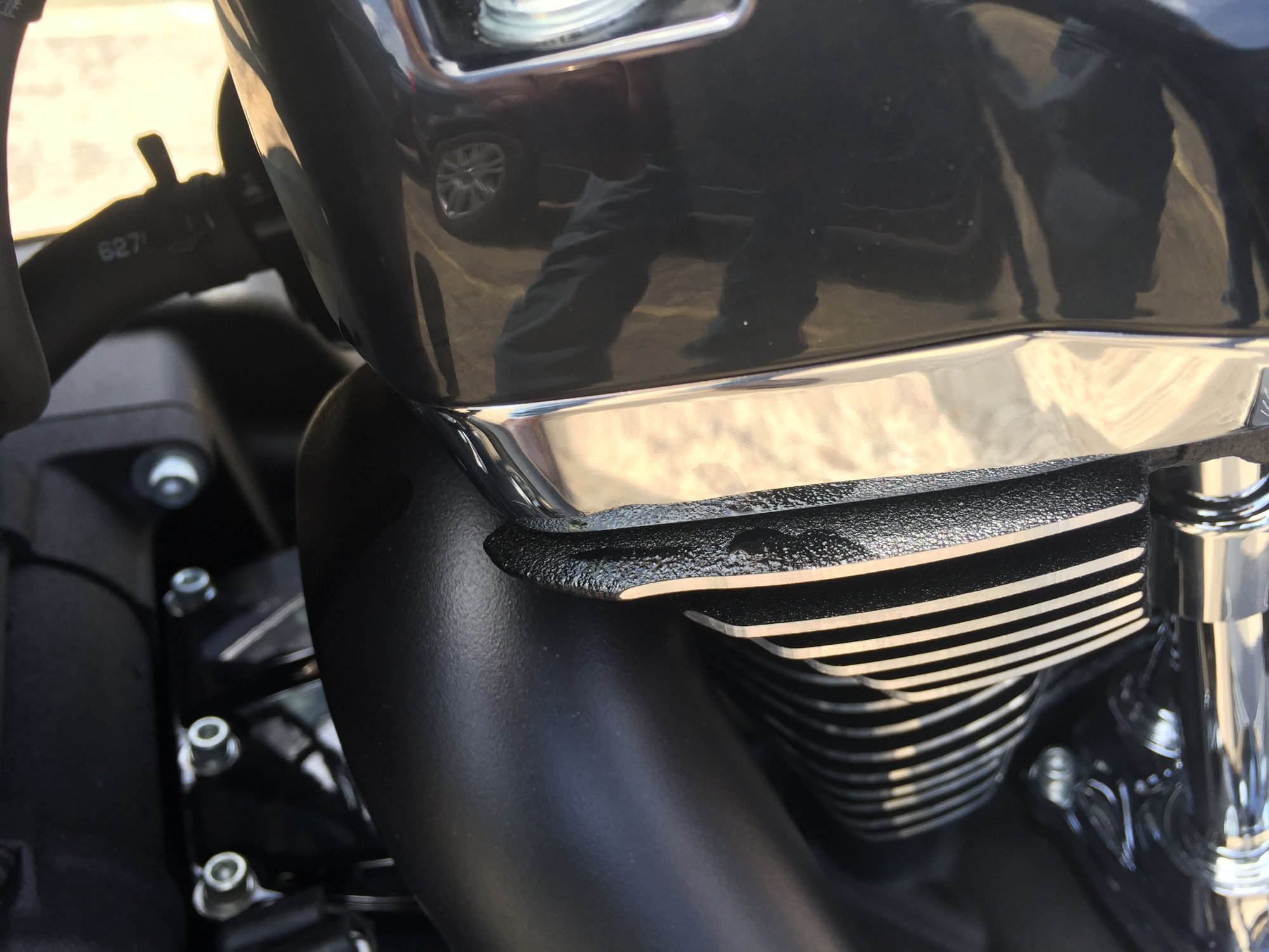

I noticed this on my rear cylinder today. Just under rocker cover. It was wet there and a drip on rear headpipe. Has anyone seen this? I wiped it off and rode and it hasn't returned. I am not sure it's a problem yet but I m keeping a close eye on it. Bike has 257 miles on it.
We got some pretty greasy bugs here this time of year.

Same thing here, and the oil light on at idle.
They are taking the engine apart right now.
Thank you
FrankEGD

What is ironic is my 15 Road Glide is in the shop now with an oil light on at idle. Hope yours is a simple fix.
