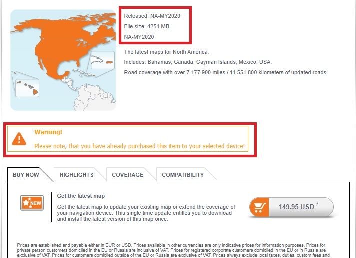

Angry Map purchased doesn't match version installed
All,
I realize this is an old thread, but I'm beating my head against a wall trying to figure out how to get the "Naviextras" real tech support contact info. I bought what was supposed to be the NA-MY2020 version as shown in the first screenshot, but after the map was downloaded and installed, it shows up as a 2018 Map version. Does anyone have a clue how to rectify this or actually get in touch with these people? I have searched all over their website and the only email address shown provides some auto reply bullshit saying you can't open a case with them by emailing and provides some other website links. Since this is outsourced from Harley, I have to assume that they (Harley) will probably be little or no help whatsoever. Not happy with this crap at the moment. Tired of "U.S. Companies" outsourcing services to other countries. Rant on pause for the moment. Anyway, any suggestions would be appreciated and thanks in advance.

Just so we're all on the same page, those who are purchasing the updated MY2020 maps; you are aware that the data used to produce "2020" maps is actually data that is already two years old? Hence the 2018 dating...
This has long been a contentious point for those on edge about whether or not to purchase the updated maps. You will ALWAYS be two years behind regardless of when you update... i.e. "MY2021" maps are being produced with geographic and road infrastructure data from 2019. In the Navi-extras world, this is how they roll. Harley chooses this to pass for 'acceptable'. Shocker.
