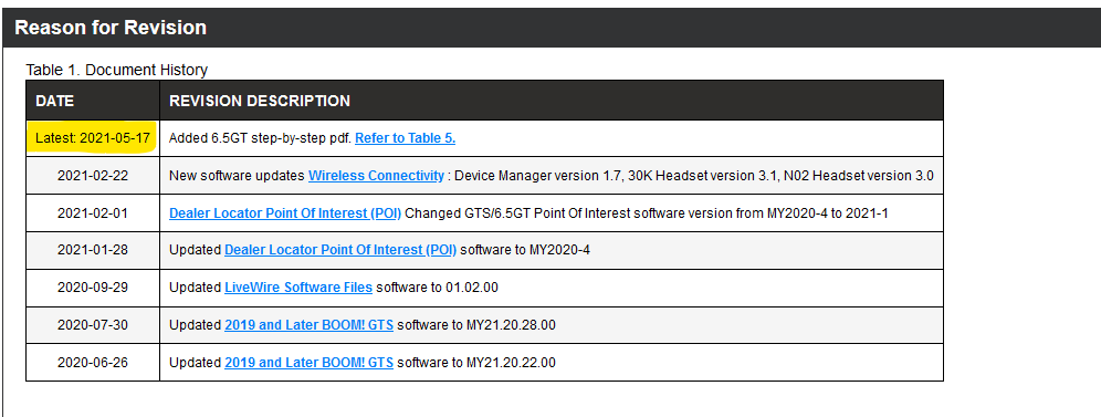

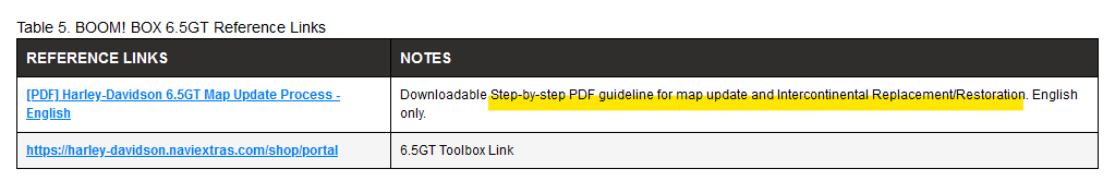

Originally Posted by hairymoth
Almost like the Motor Company saw your post.. yesterday morning I noticed an update on the H-D page with new instructions for the map update. (Actually, I suspect that a new, 2021 map update will be announced shortly, and the complaint of the beta testers was loud and clear: "the documentation for the installation procedure sucks." THIS IS JUST A GUESS). Anyway, there is new documentation on the H-D page, go to the bottom of the home page and choose "software updates". Remember, the upgrade is installed, using the toolbox, into the fingerprint on the memory stick that contains the fingerprint, then the update is essentially transferred from that fingerprint to the bike).
So, I read your comments, and they helped me to find the 'free' page with the North America GTS file, and I downloaded the step by step instructions. Unfortunately, the PDF only explains how to purchase and download the update, and not how to place the update from H-D.com on the Jump drive and get the software to recognize it. Has anyone been successful with this?

H-D has recently but together this detailed instruction sheet on the process. This is more involved than a software update, it is very non-intuitive, you will need to read the instructions.. Summery: You first need to create the fingerprint file, of you bike, on a USB, then using a computer, update the bike's fingerprint on the USB and then put that back on the bike. Here are the instructions.
https://serviceinfo.harley-davidson....31886064531733
