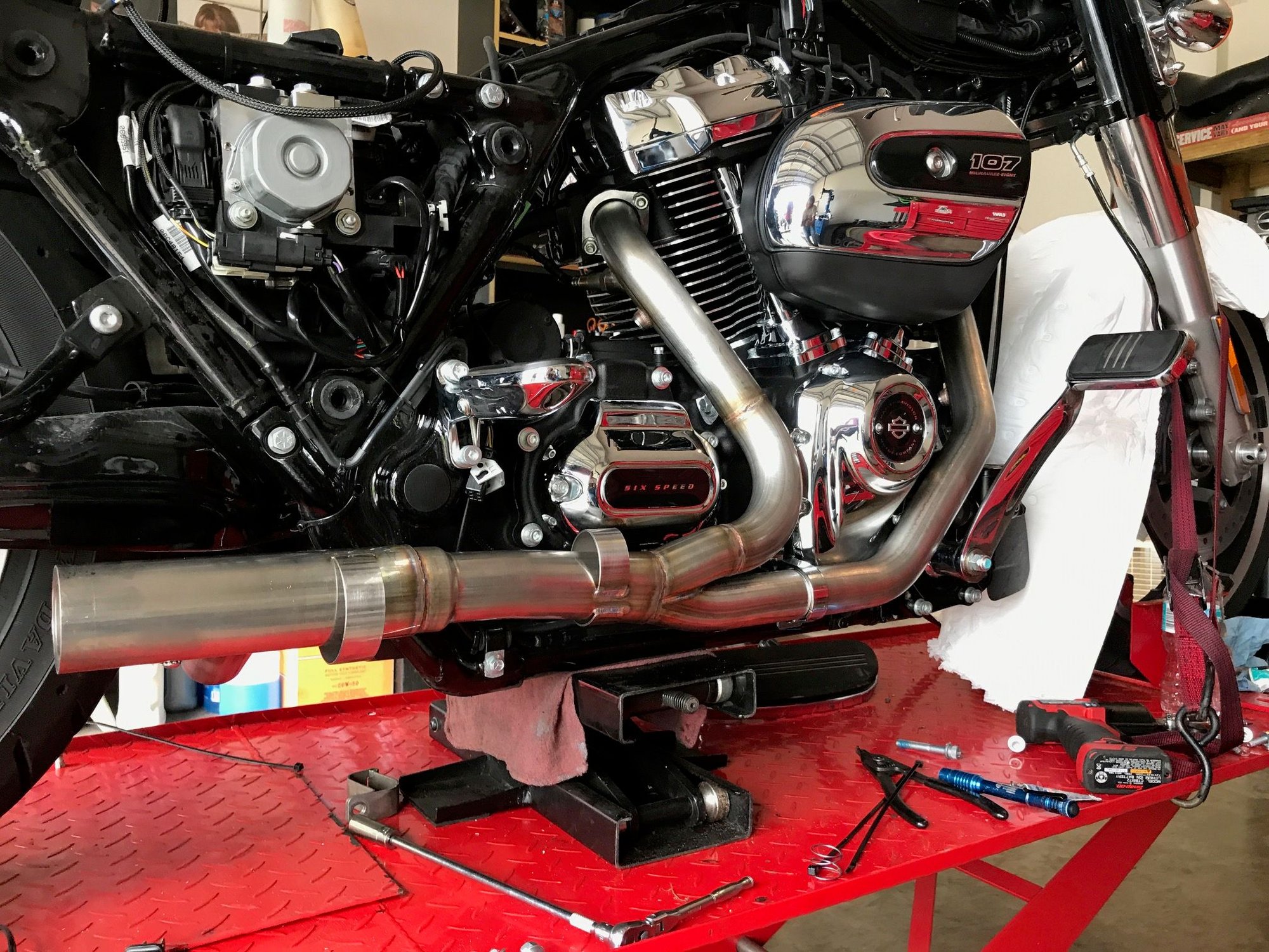

FWIW. I have received one of these. I installed it on my RK. Fits great, sounds great, runs great. So far motor only has a ventilator AC and Fullsac Re-cored mufflers. I am running it with a V+H FP3.
In my opinion, I find the price more than fair for the materials and workmanship on this piece. Nice job Fullsac.
