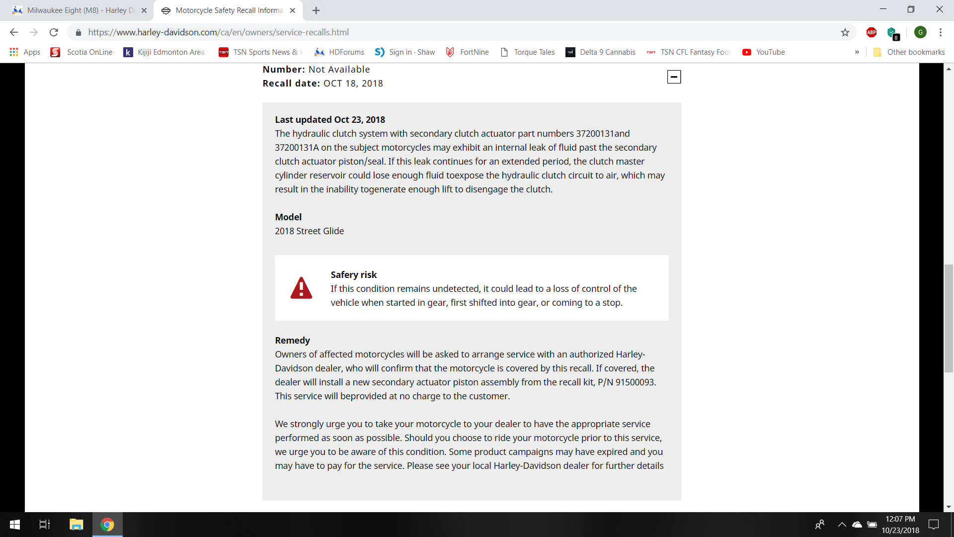

Here's the full text of the recall from the Harley website:
(Model shows 2018 Street Glide because I searched for the recall using my VIN number, all touring models are potentially affected)
