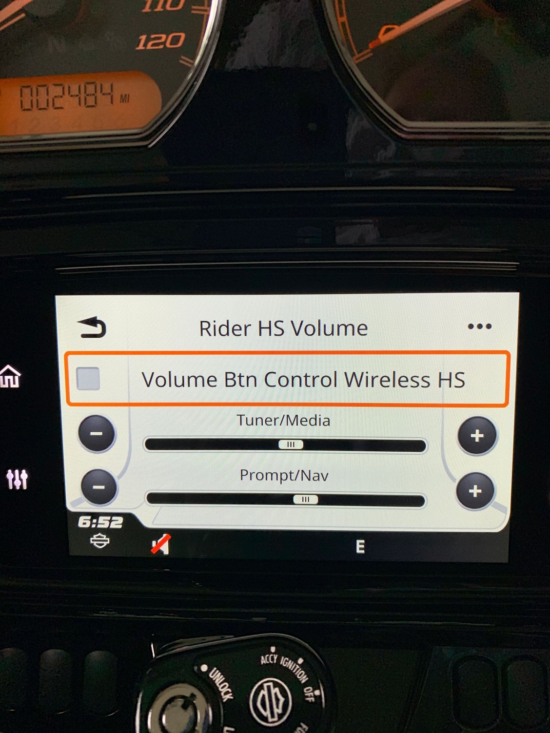

turn on bike to accessory. turn on headset so it connects to the bike. turn volume control on head set to maximum.Go to settings->audio settings->rider headset volume->"volume btn control wireless HS" and turn that off
That's fixed it!
Thank You Sir!

this is for the Harley branded 20S EVO headset
headset has to be turned on and connected to bike and the buttons should show up

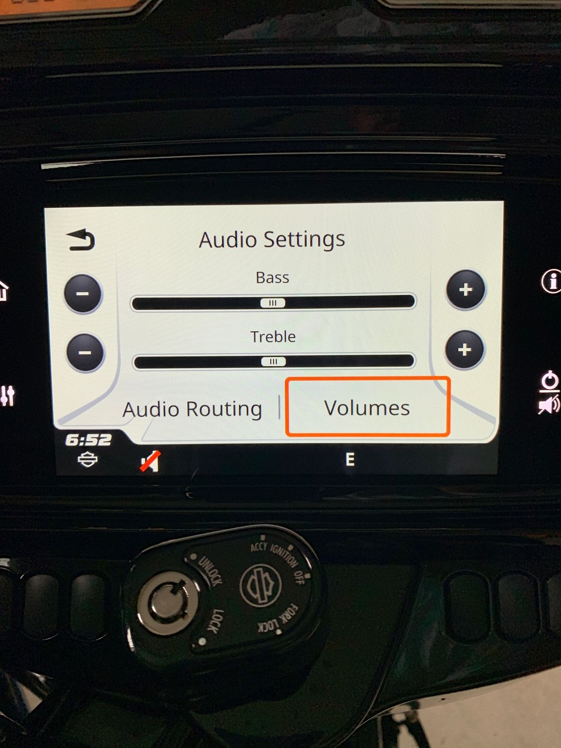

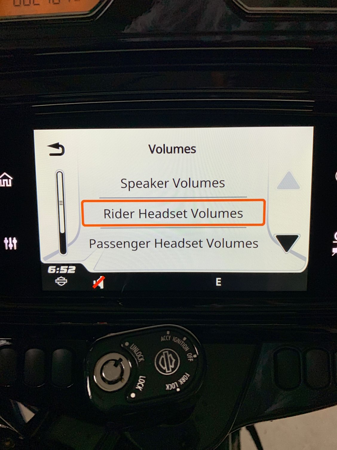

Here is the path to the volume button, it's through the audio settings window, not the wireless headset window:
Thanks for the very detailed post. I really appreciate it. However, I do not have that check box even showing up. I just remembered that I have my headset paired to the WHIM as a GPS unit and maybe that is why it is not showing up. If you are wondering why I have it paired that way, please read another post I wrote by following the link below. The gist of it is if I pair a non Harley headset to the WHIM using the normal method, I cannot communicate with my friends using MESH mode. I was able to get everything to work by pairing it as a GPS. The problem I have, and I need to do more testing, is that the volume for our voice communication seems to be incredibly low and I max out the volume on the headset to no avail. The bike seems to somehow be controlling our voice communication volume.
