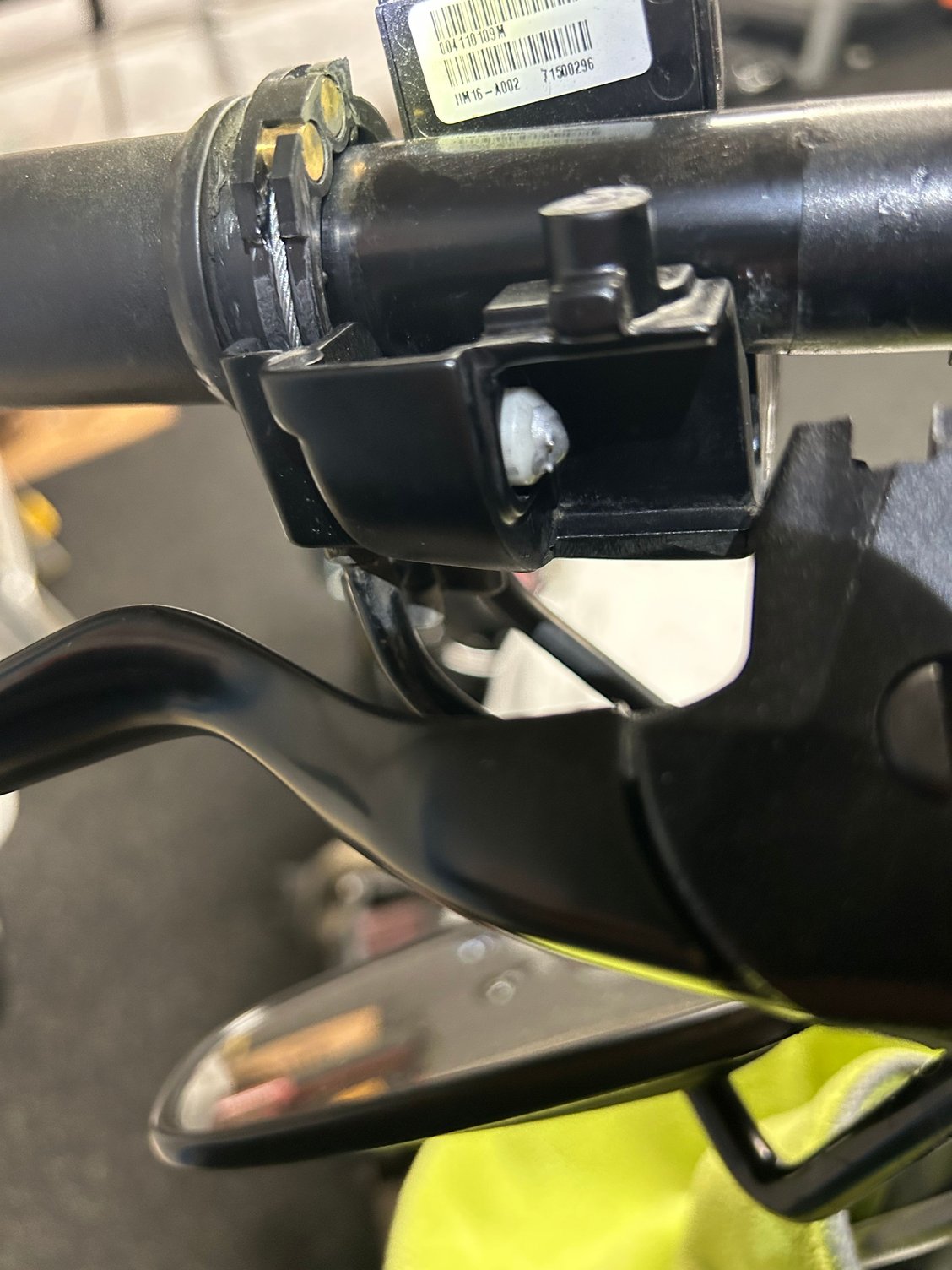

I’ve got a 21’ Forty Eight, say 6,000mi. While on a ride, red indicator light came on, and went away shortly after(on for 5mins). Nothing felt/ sounded abnormal mechanically.
Checked codes when I got home (B2151,B2156 & B2262),did a once over on the bike, cleared the codes. Nothing obvious.
1 week later, while riding red indicator came on, cleared itself in less than a minute. So I decided to dig into it.
What I found is that my brake lights were getting hung on. This only happened when I hit the front brake vs the rear brake (operating as intended).
By removing the right hand controls and parts, I was able to find that the brake lever, which is notched to open a contact when the lever is released, but was not depressing the contact to open.
White tip with anti-seize is what is pushed in when the brake lever is released, thus turning off the brake lights when the lever has been let out.
