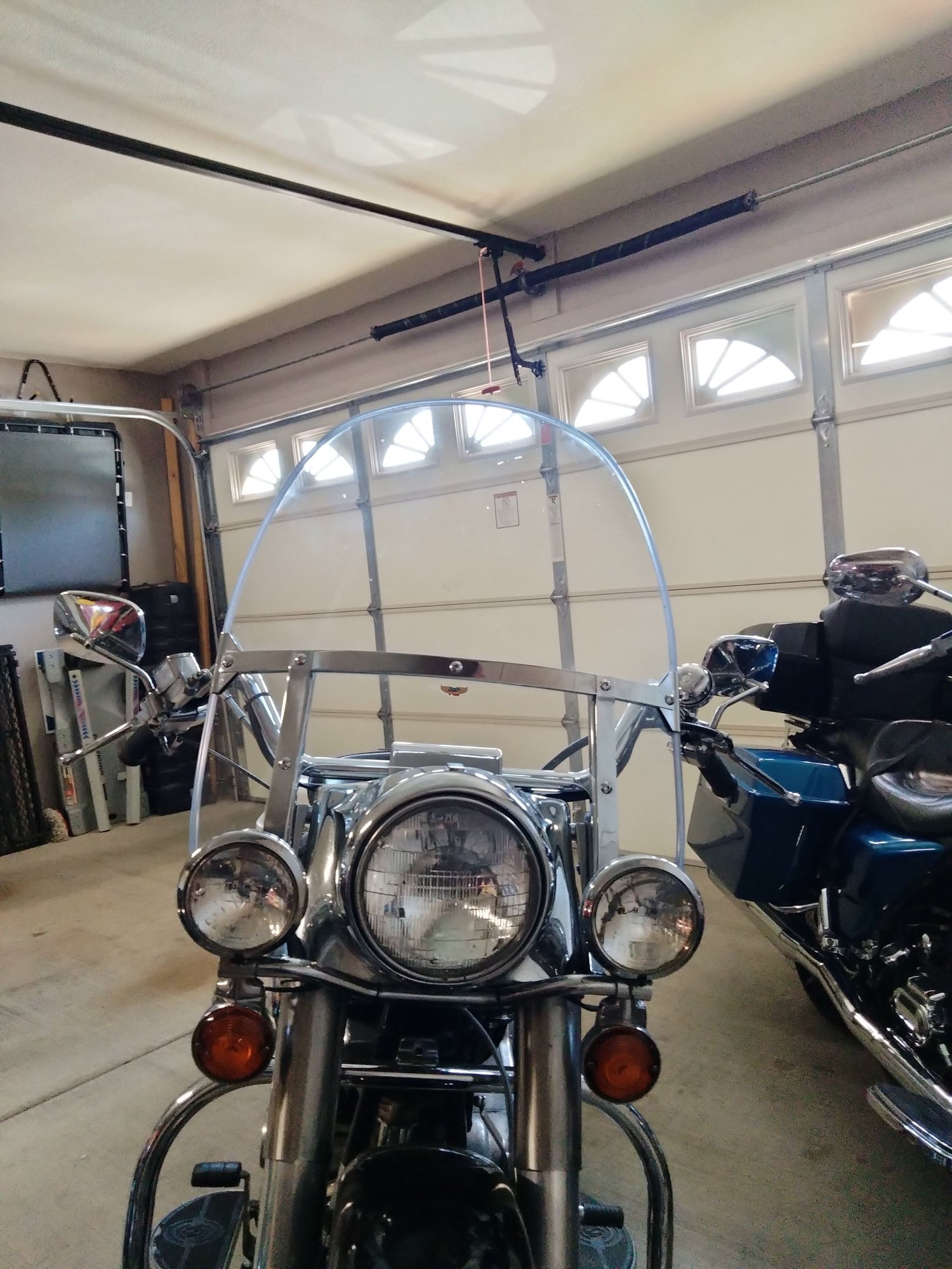

I don't have experience with those windshields, but there is a way to figure the correct height. I don't remember if it's 3" below your nose, or something else. I've used two of these recurved windshields on my road king and they do a great job, may be what your ex-FIL had?
https://www.clearviewshields.com/mot...-hole-pattern/
I got the taller 21" version because I have a police seat. They don't sell brackets, though.

Thanks for this. I actually got ahold of my ex-fiancé who put me in touch with her Dad last night. He (thank goodness) is still riding. He's retired to a 40-acre ranch in the Ozarks, and says I should ride the Pan-Shovel out there when the rebuilt engine is broken in and do some horseback riding on the ranch. Good chance to test out the windshield?
Anyway, turns out he actually had an OEM Road King windshield on it. But I like the unobstructed view of the road--and conversely of the bike itself--provided by the Clearview's non-beaded edges. They claim as well that it's thicker and more rigid. No issues with it flexing a bunch at speed? Also, it sounds from your experience that the recurve may reduce buffeting even further? Price is about the same.

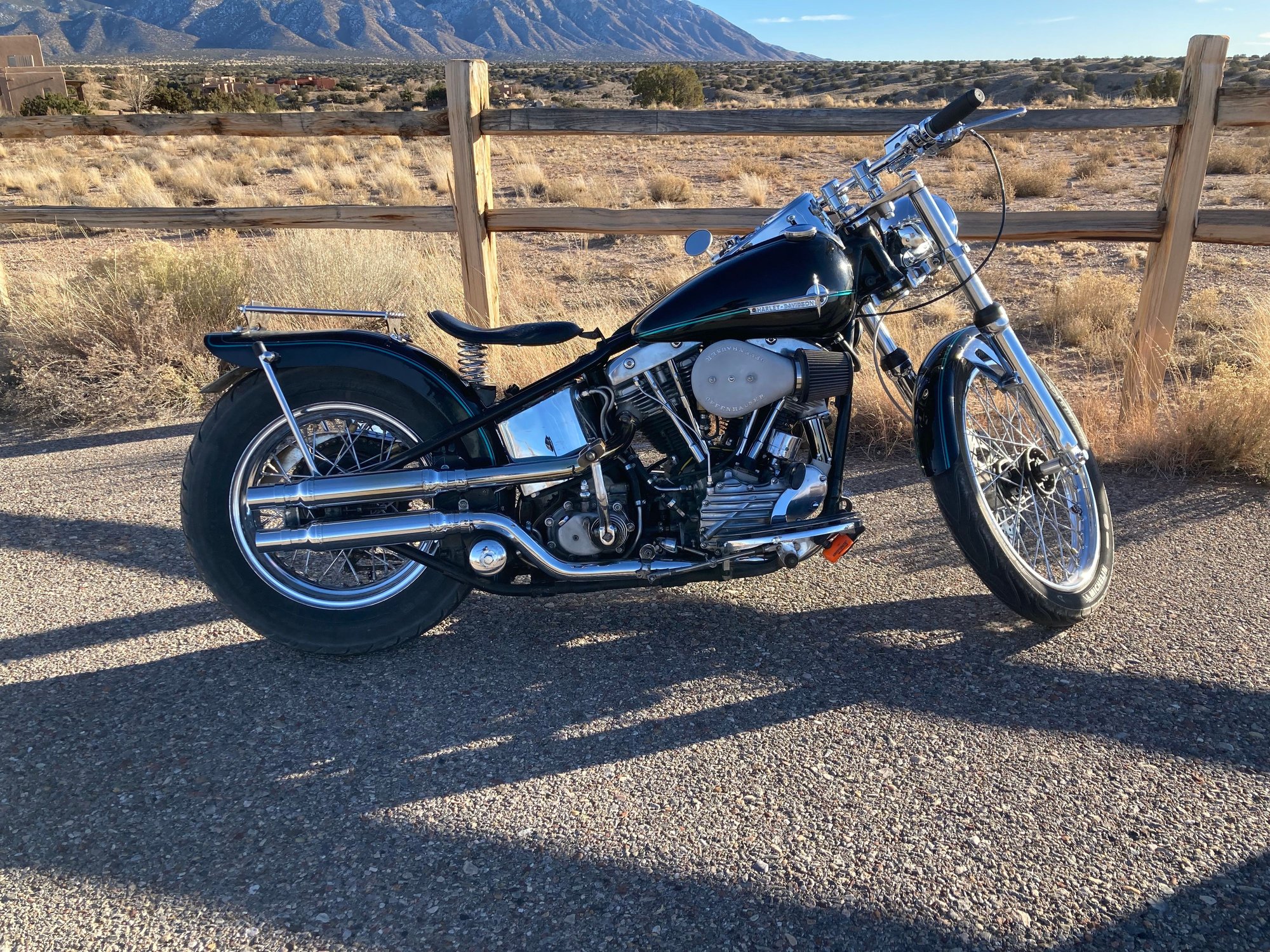

As to height: okay, I gather the idea is to be able to just see over the top. I'll take some measurements and see whether things would work out with my low saddle. Here's a roughly accurate sideview showing about where I sit...

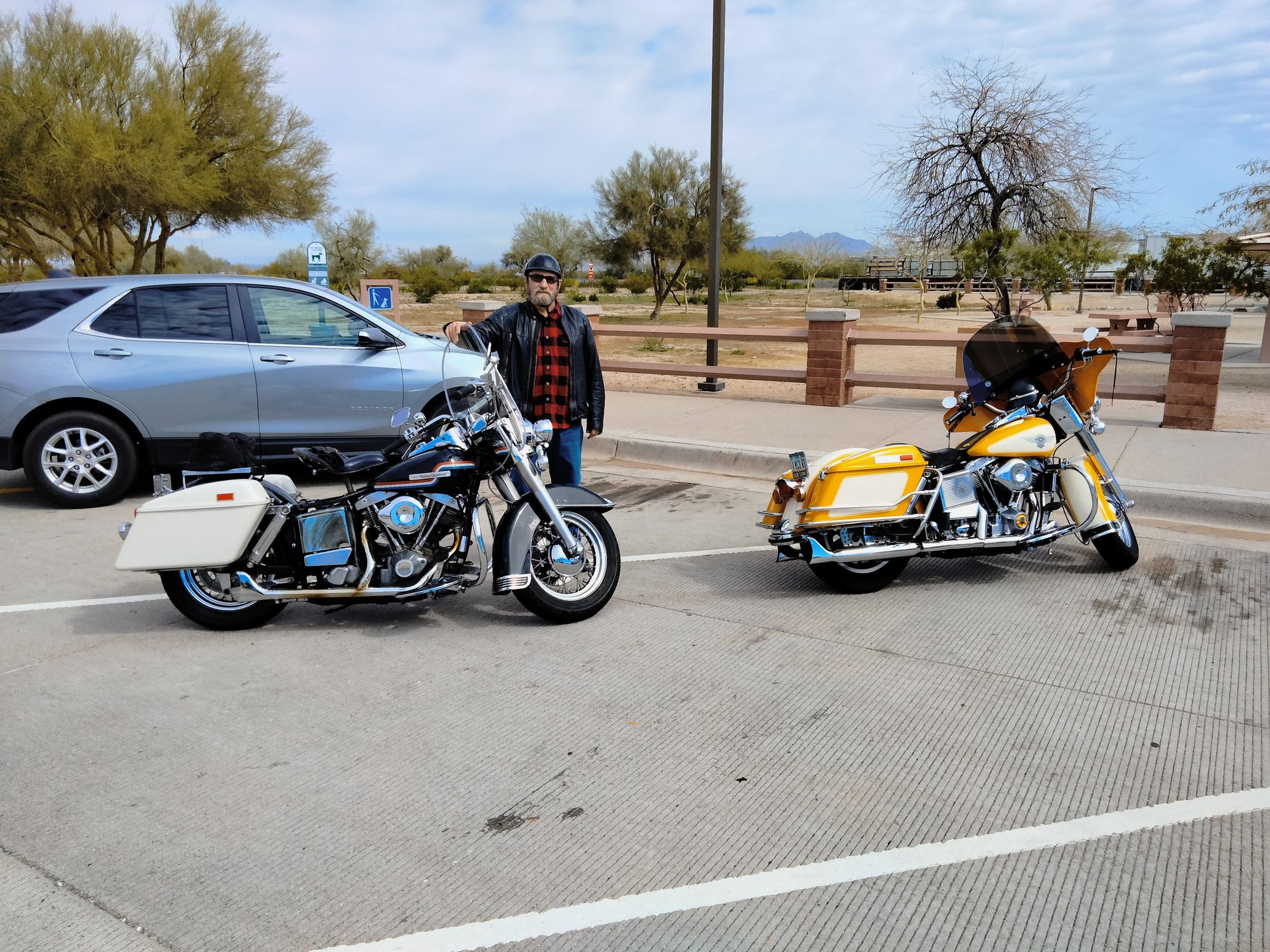

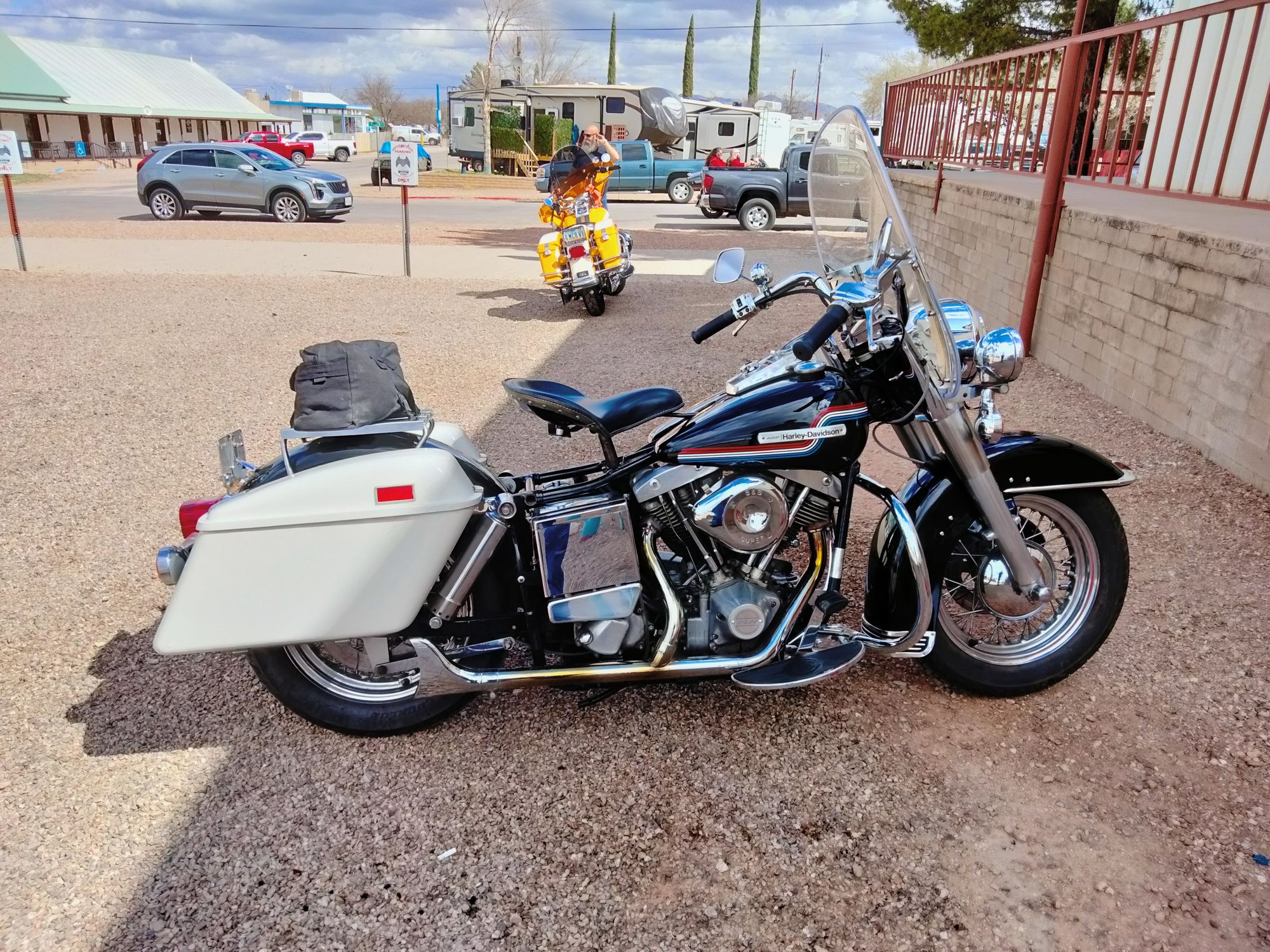

NM Pan-Shovel
I picked up a National Cycle Beaded Heavy Duty windshield about a year ago at a local MMI Motorcycle Swap Meet. It was new in the box and came with 2 sets of Brackets, I used the Polished set. The windshield is well made and bolted right up to my 75 FLH. I have been very happy with it.

Originally Posted by NM Pan-shovel
Photos...? What's it like sitting behind it at, say, 65~70 mph?
The windshield makes for very comfortable riding, top of windshield is about even with the bottom of my nose. With the windshield on I can easily ride all day, without it I'm usually done after about 300 miles. 65-70 is the Max Speed that I ride this bike, I have a Road King and an FXR if I want to ride fast. I couldn't believe how lucky I got that day at the Swap Meet, picked up the windshield and a FSM for my bike that day for a little over m$100.00.

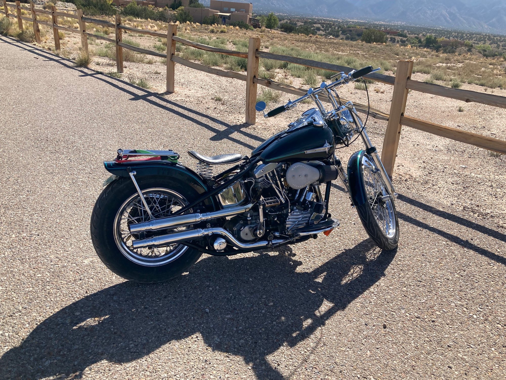

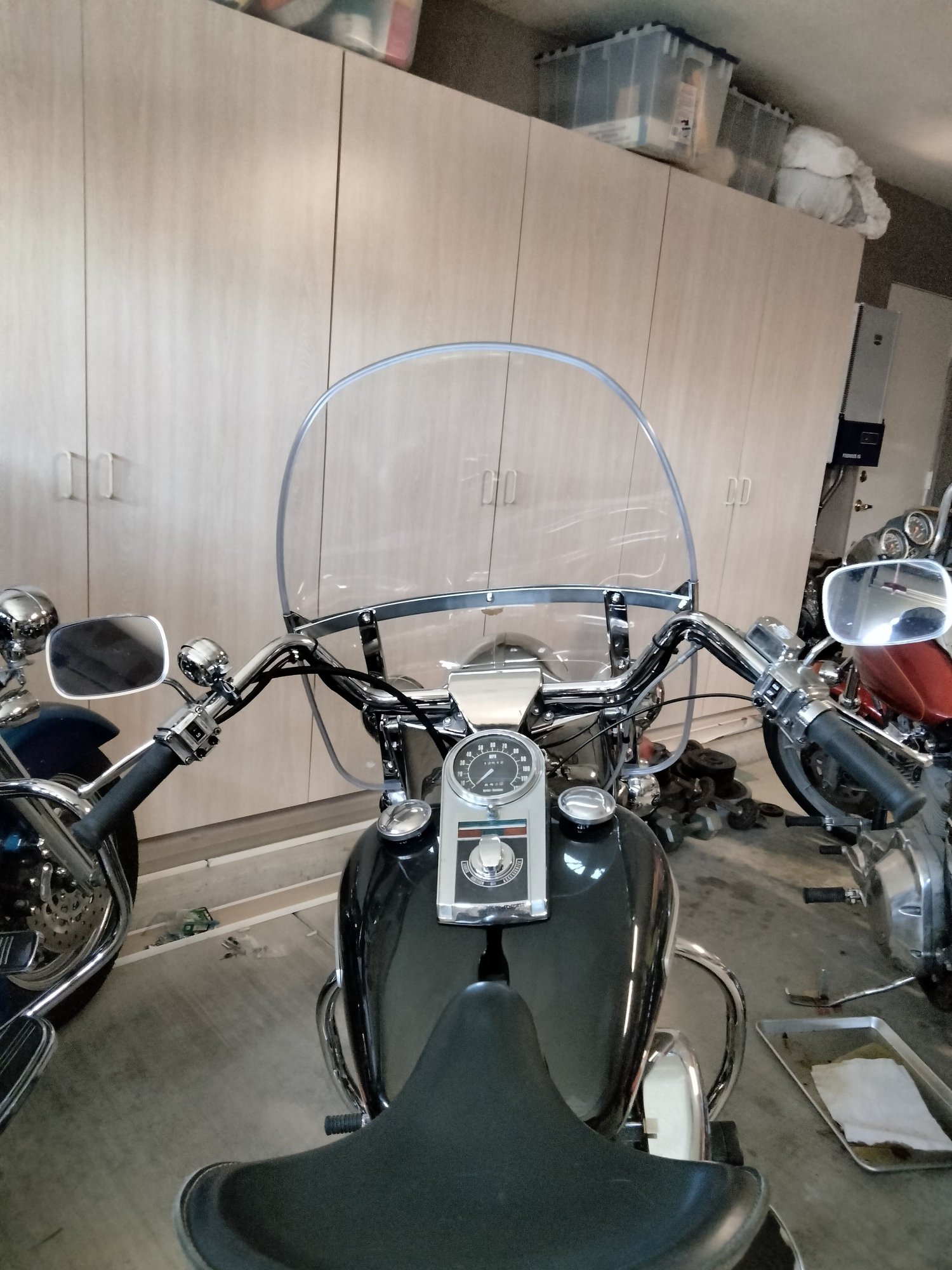

Hmmm... well I must say I kind of like the more period-correct look of the National Cycle at first glance, and cost-wise you get the brackets as part of the deal. For sure, with either windshield I'd have to reinstall the 5-1/2" slightly bent-back risers I had on originally, shown here, as I think the drag bars might cause the master cylinders to foul the windshield.
Need to mull things over. That's a dynamite-looking Shovel, BTW.
