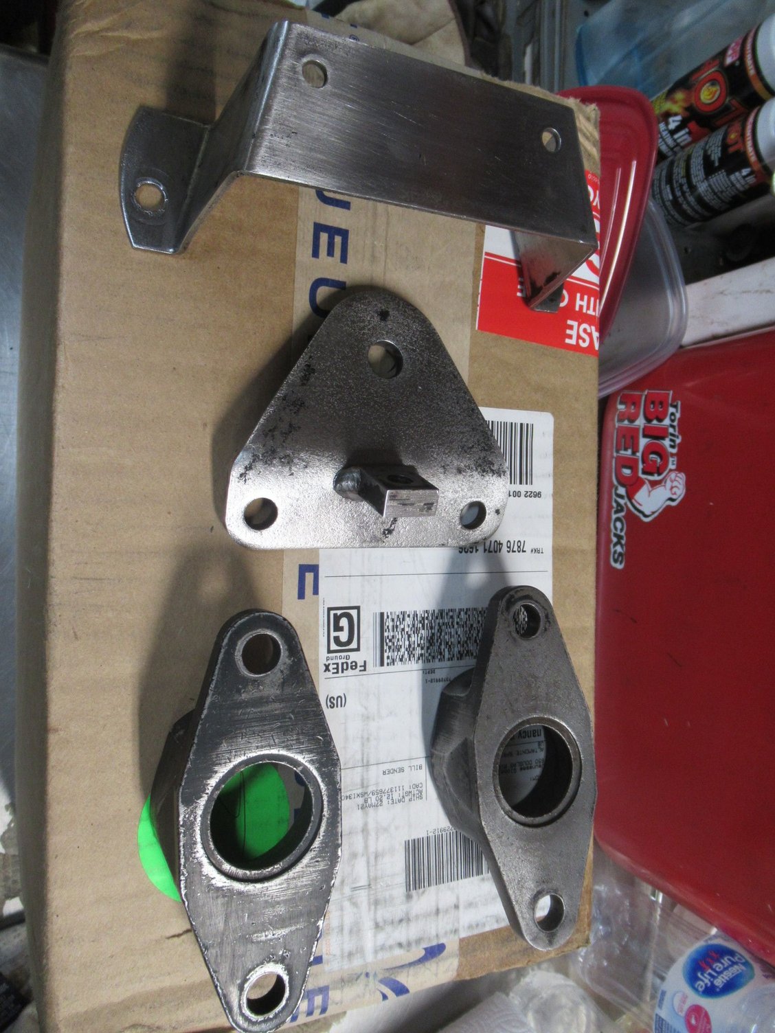

Rainy weekend gave me time to clean up some parts, getting ready to paint them later this week when it's warmer and drier.
These will get a coat of clear to preserve the finish:
These will get painted black like the frame:

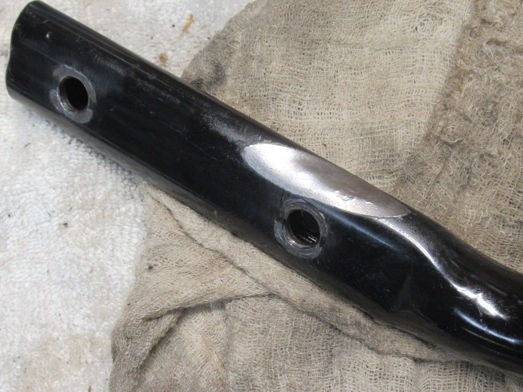

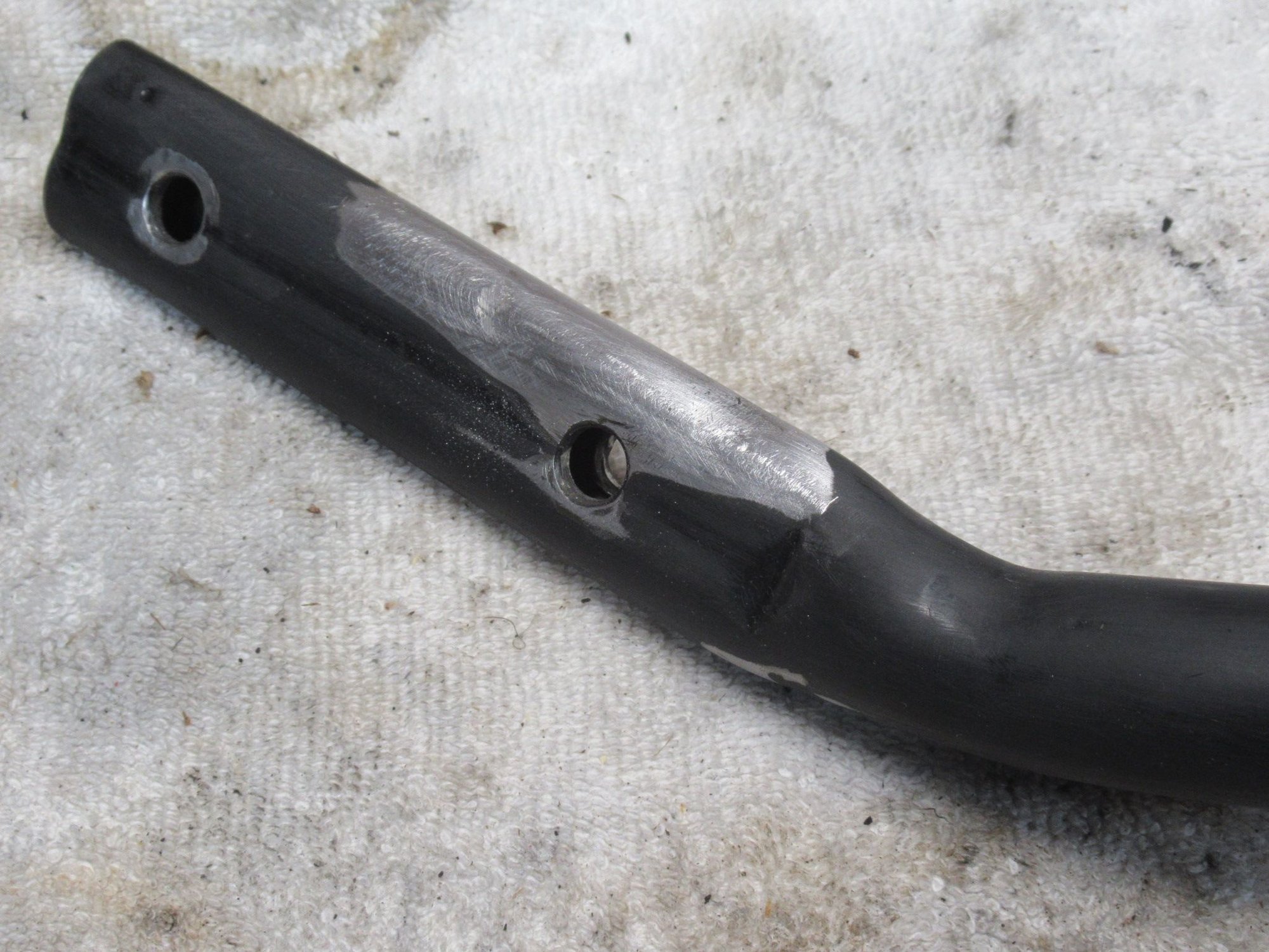

The muffler mount was worn like the frame was, so I fixed that. Interesting that it is power coated. Maybe the factory was transitioning to powder, but not doing frames yet?
This is why the mount hit the frame. I'll have to get a new one and do a better job aligning the pipes.

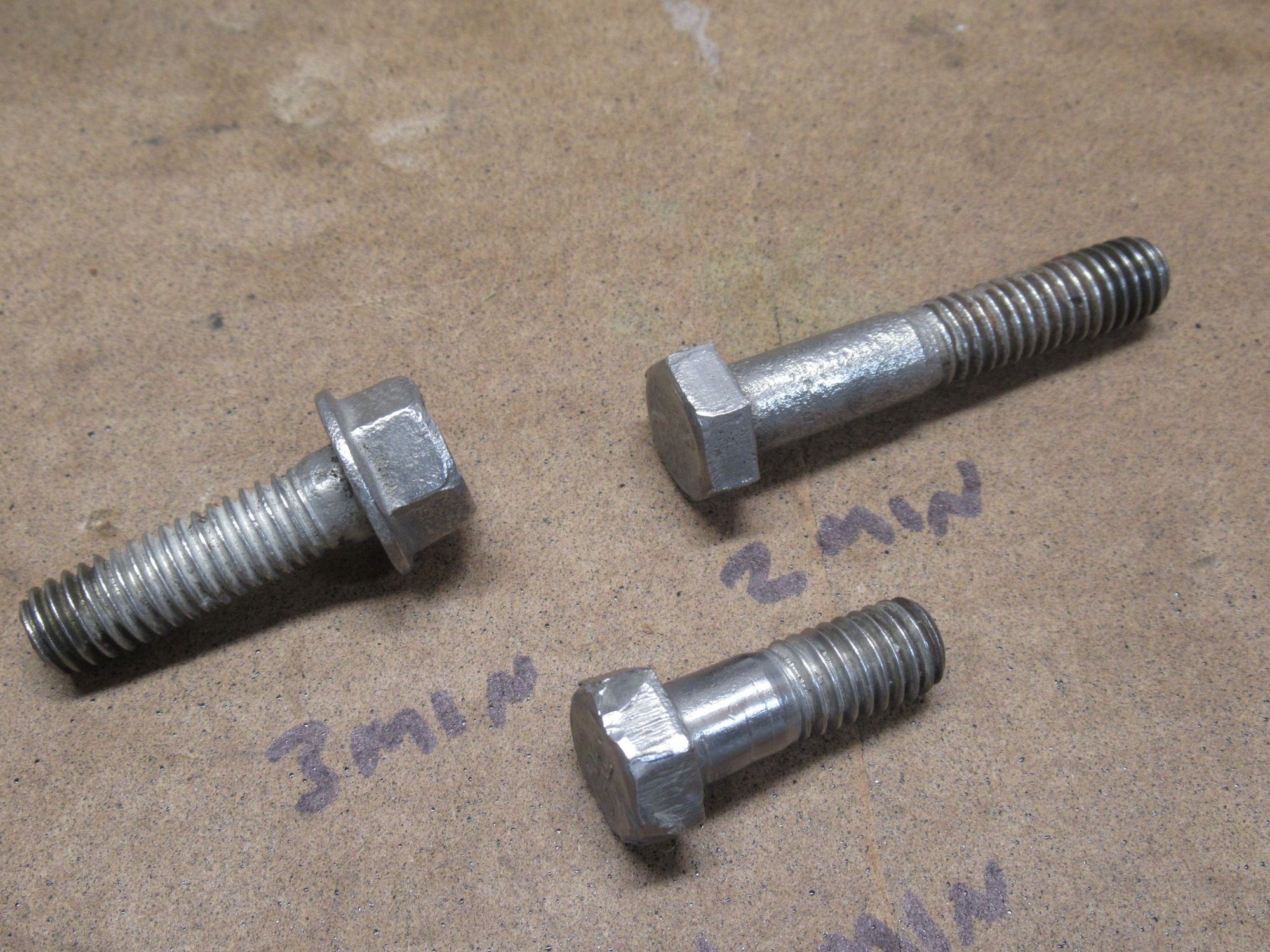

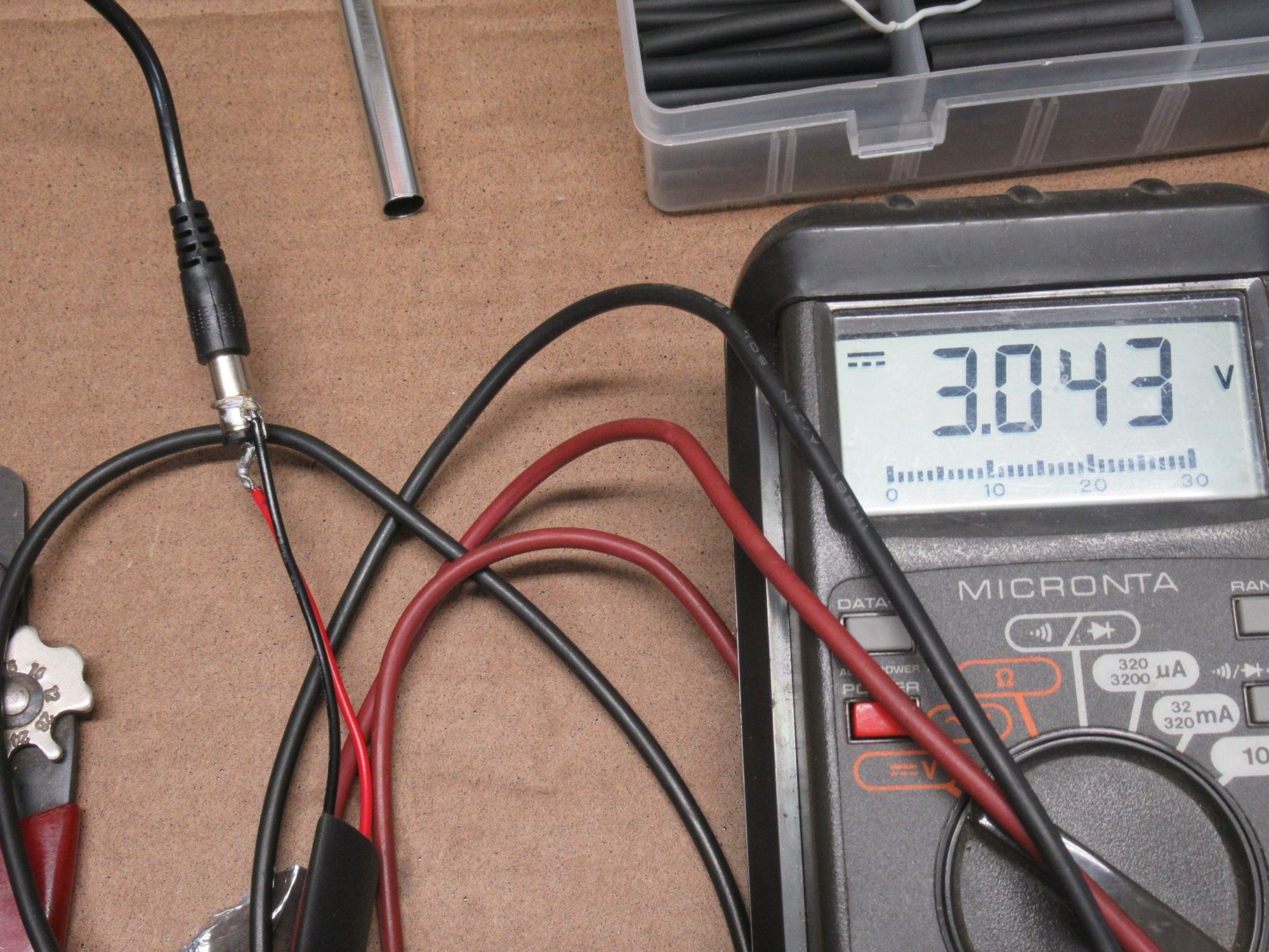

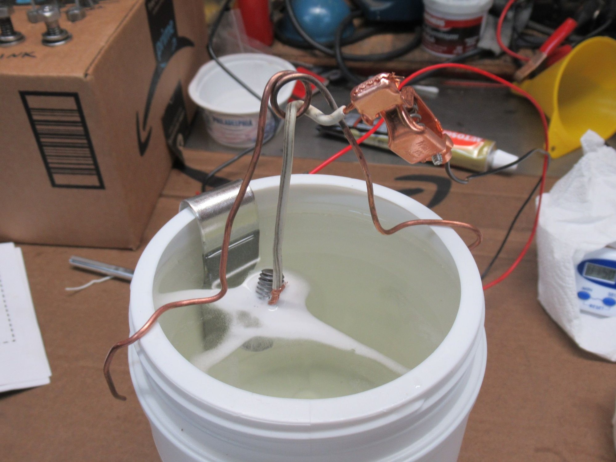

I decided to try the Eastwood plating kit, but got a 3v charger to replace the two D-cells. A little cutting and soldering on the adapter they included with the charger, and I'm in business.
They recommend a few test runs to get the timing right, so I cleaned off a few rusty bolts and gave it a shot:
Three minutes later:
The gunk cleans off with water. Seemed like too much so I did 2 min and 1-1/2 min. This is how they looked after polishing. Two minutes seemed best to me.

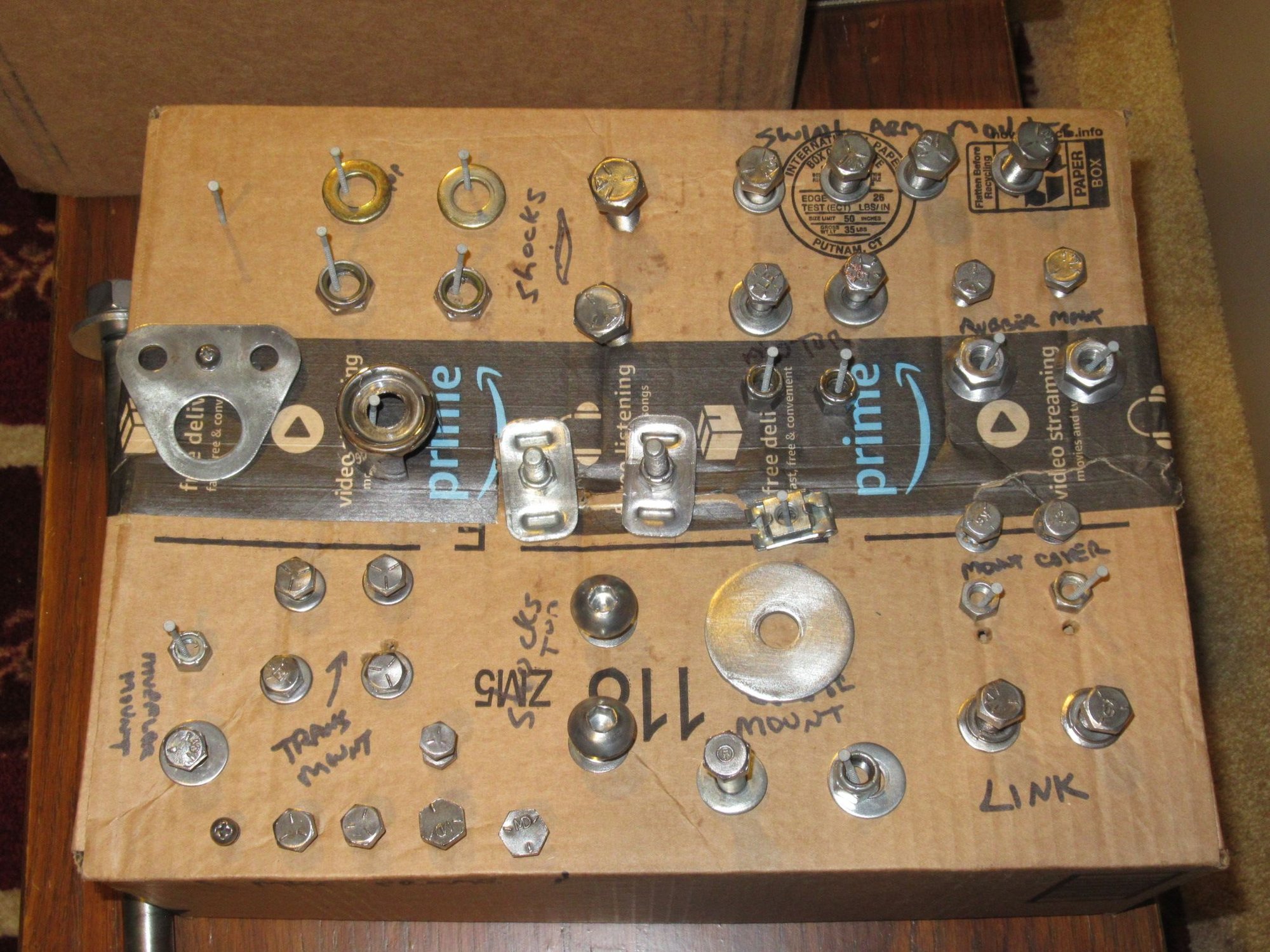

First real part was the washer for the front motor mount:
A few hours later, my box of bolts was all plated, but not polished:
I took them inside to polish - it was getting too warm in the garage. Got halfway and wasn't convinced the plating was right. Then I got to this bolt that had some copper stains on it before plating, and still does! Maybe I should have cooked it longer? Waiting to hear back from Eastwood, but the instructions did say 3-4 minutes for a typical bolt.

what is the plating material, Zinc dichromate, hexavalent chrome, tim..... I didnt see any plating ***** in the soution.
