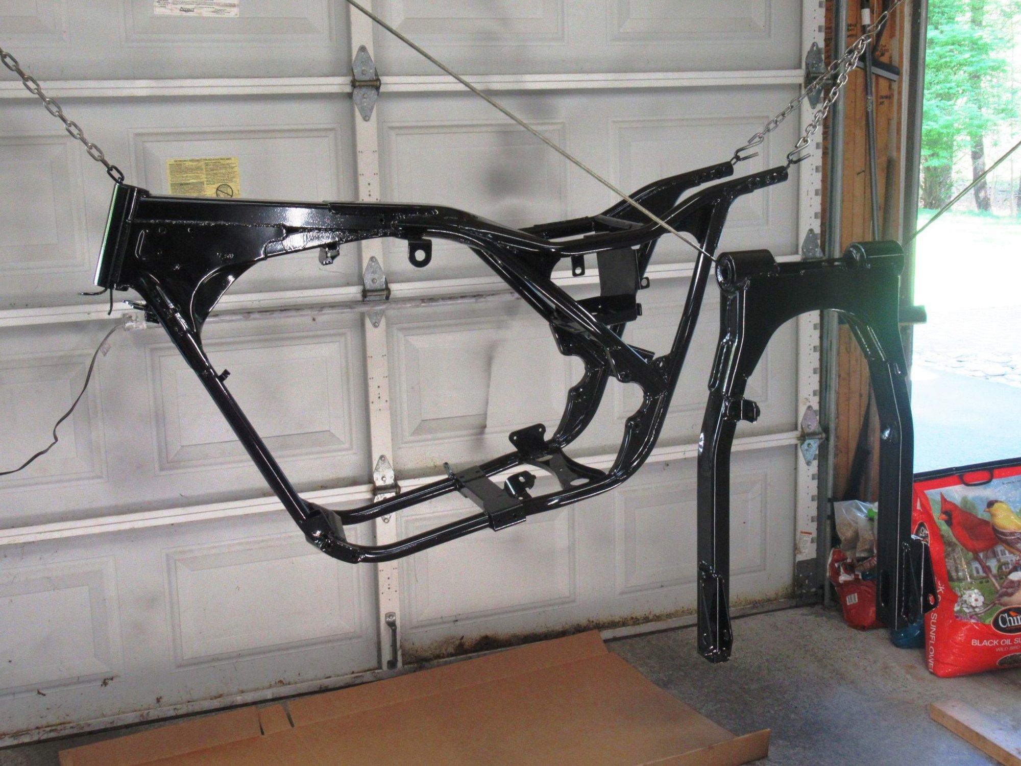

The weather finally got to where I could paint the frame, almost 70 today. First thing I had to do was a quick repair on the swing arm, I didn't notice this until the other day.
This will help keep the back wheel where it belongs, and the ugliness can't be seen when the wheel is on.
I spent a few hours sanding the entire frame and swing arm, getting into the nooks and crannies the wire wheel couldn't reach, and giving the metal some 'tooth' for the paint to stick to. The directions on the reducer say no primer, so the metal prep is very important.
Last picture for today is the spray booth. The local hardware store sells LED bulbs subsidized by a state program, and yesterday they got 4-foot shop lights for $5, so I bought six so there will be plenty of light.
The paint sprayed out very nice, one wet coat flowed out beautifully. Tomorrow when I get home from an AMCA ride I will take pictures of the results.

What's behind curtain #1, Monty?
