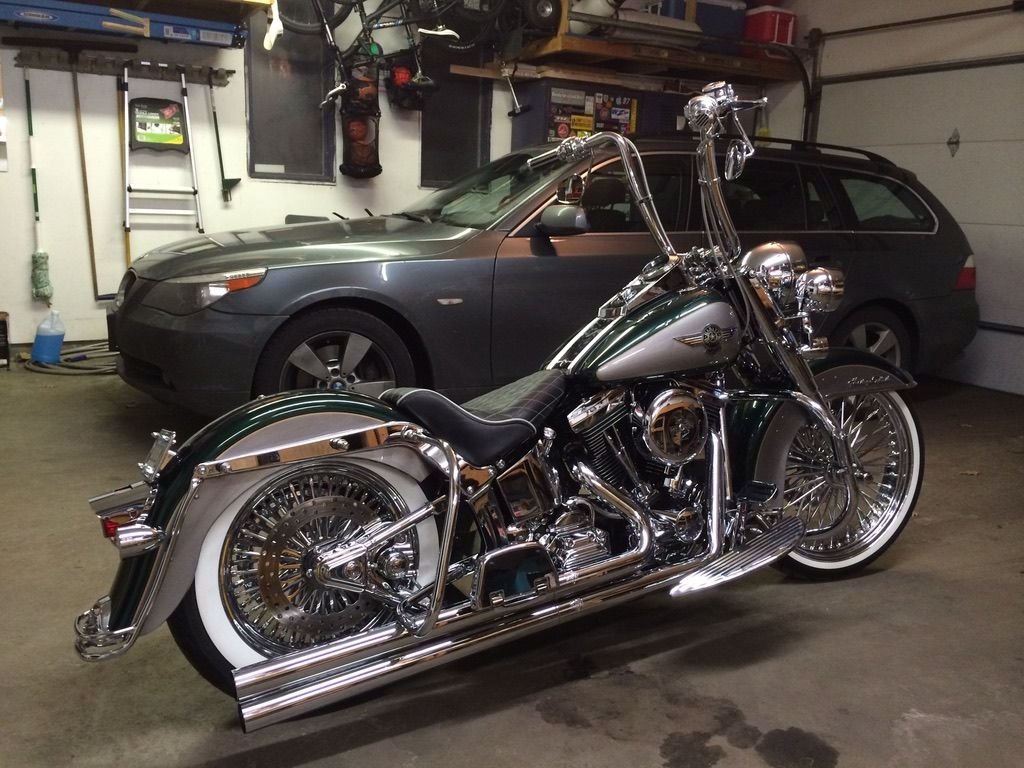

great choice! This is my 96 FLSTN. There's really only one Evo cam that is widely used, Andrews EV27 so you'll want to know if the cam has been done. If not and it's 100% stock, no big deal but you'll want to inspect the cylinder base gaskets because a bike that old is likely to have sprung a leak in that location if it's not been ridden consistently. As far as the remainder, you'cve got the standard questions and hopefully he'll be honest with you. You can look up the date codes on the tires but if there's any doubt on them, replace. Same goes for the battery. For the nostalgia specifically, they had special seats and bags that match. The seat is a two piece seat with black on the outside and a gray stripe down the middle of both the rider seat and the passenger pillion. The bags that came on them were black with a gray inset and they had two buckles on them, like a belt, not a snappy-clicky thing. I didn't keep those on mine but I kept all my original parts in case someone wanted to return it to stock.
There were 2,103 of these 96 FLSTNs built with 1000 of them going into Canada. It's a great bike, unique paint and probably stands as good a chance as any to be worth something in 20 years if it's well kept. I don't know the price tag on that but I have to think you'll be able to get that bike for 7k, even if the current owner is aware of it's rarity. Mine also didn't come with the spots but I liked the look so I added them. If you have any other questions, let me know. I loved mine until I moved it on down the road.

Thanks. That is a beautiful bike. Is that a 21 wheel? Was is a straight bolt up or did it require any other mods?

Bolt on, no modification needed although I added a chrome rail that went around the front fender shortly after the 21 went on and that tire was VERY close to the front mount of that rail but it never touched it, even on very hot days of running hundreds of miles down the road at highway speeds. I was nervous to begin with but after checking it multiple times it became clear that the tire wasn't going to make any contact.
