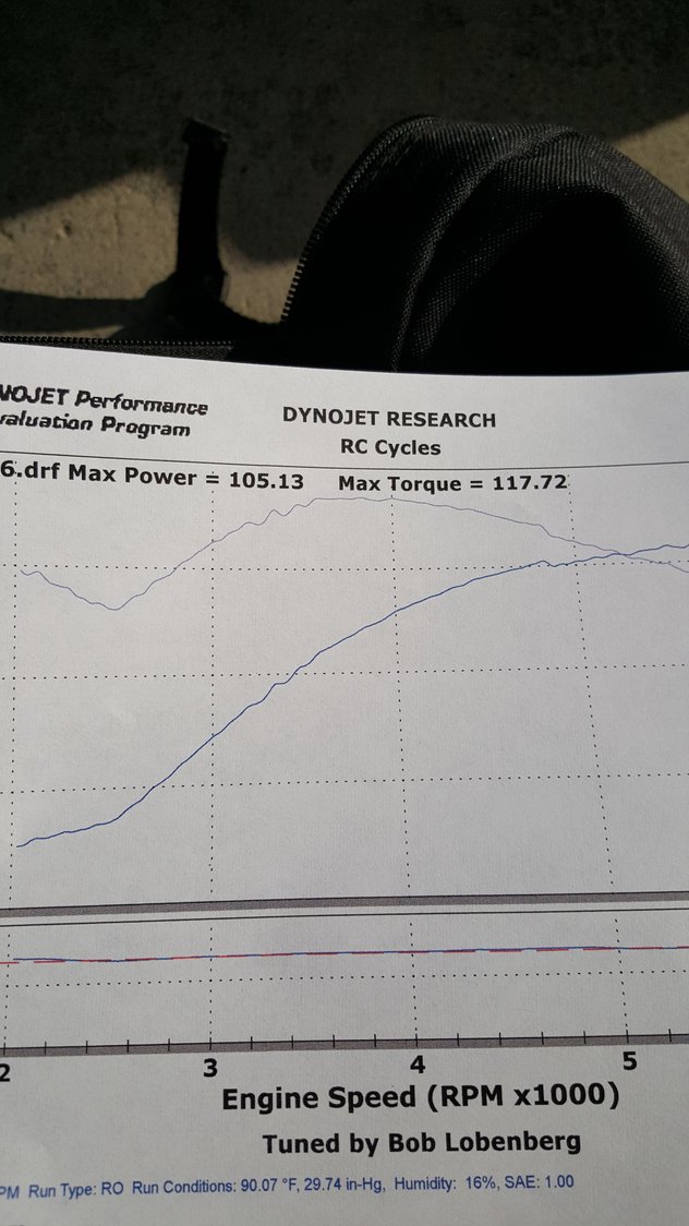

Originally Posted by xdaltonx
Im also looking into the cycle-rama 575. Seeing some pretty good numbers from it
Well i ended up with andrews 57h. Had rc cycles in hayward do the install/dyno
I got 105hp and 117tq
Specs:
2012 blackline fxs
Stock 103 no headwork
57h cam
S&s lifter and adjustable pushrods
Arlen ness inverted big sucker
Bassani road rage exhaust
Power vision tuner
SE performance clutch
