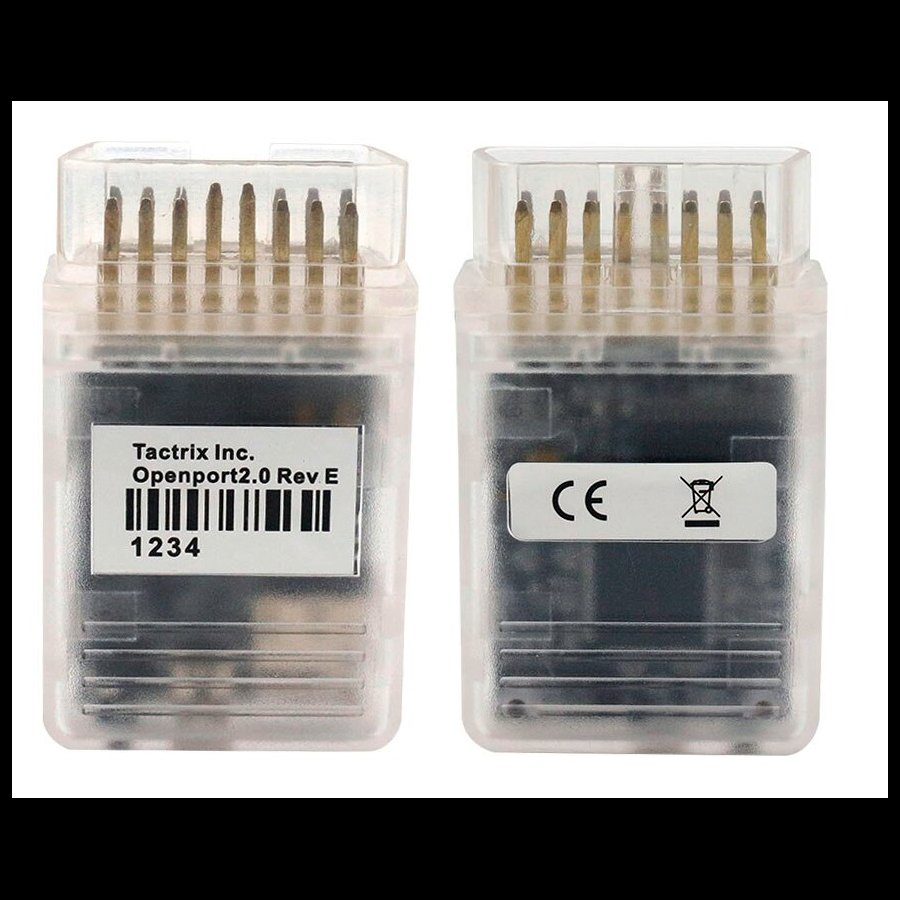

What i would like to do is just pair it with my ecm, but i need a cable to do that.

If you would like to pair your dashboard with the ECM remotely, I can help. You need an adapter OpenPort 2.0 (cheap China copy is for $30) and the diagnostic cable OBD to 6 pin Harley port. For a new one- OBD to Euro 5 cable. Also can buy AliExpress. Laptop, fast internet connection and 15 minutes free time. But you must to know, if the mileage in dashboard MORE than in the ECU, the mileage in the ECU will be the same as dashboard after pairing. In this case, I also can resolve.
