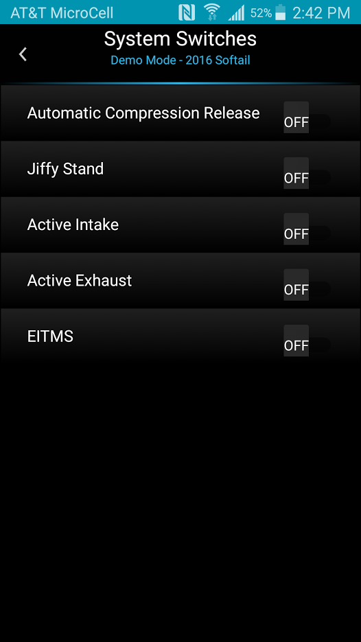

Originally Posted by TeaRunner
Which app are you using? Android or iOS? Haven't seen any of that in the Android.
Android... here's a screen shot from my Samsung S5. You may also want to make sure that the ACR is on... if you want it to be.
Got it working. I needed to complete a firmware update but couldn't ever figure out how to get that going. Turns out, I had find where to turn the autotune off before the option appeared to go through the update.
Update completed and then the world opened up on the app.
