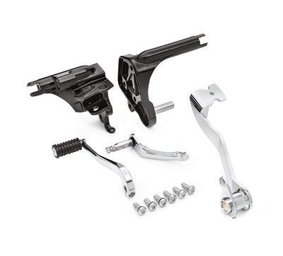

These are the exact parts you NEED to make the swap.

I have a 13 Fatboy and converted it to forward controls. Nothing from the old setup will work. I bought the conversion kit from HD, and it had everything you need except the pedal pad, the shifter pad, and the footpegs.

Will this kit fit my 2014 Slim if fitment is described as per below?
Harley-DavidsonŽ Extended Reach Forward Control Kit - SoftailŽ - Black - 49223-08
Also available in Chrome, P/N 49171-08
Fits ’07-'15 FX SoftailŽ models (except FXSB, FXSBSE and FXSTD). FXCW, FXCWC and FXS models must reuse Original Equipment footpegs. Not for use with accessory Shift Linkages. Separate purchase of model-specific rear brake line is required.

Yes, you can make this work. You will still need the remaining controls tho.
