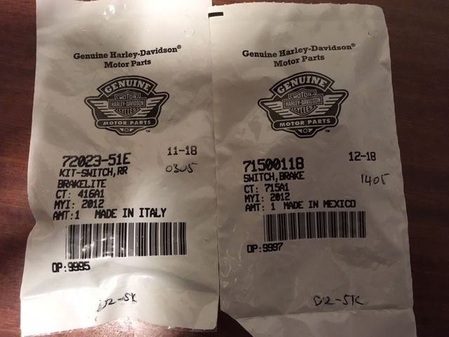

So I managed to go shopping today, bought front and rear brake light switch at the local dealership. Turns out the back one is a bit more pricey than what you can find otherwise on the internet, but it seems that recently a number of the made in china / taiwan switches would just come apart rather quickly, leaking brake fluid right onto the track of one's back tire. Not exactly what I am looking for...
The front one was the same price as any replacements to be found from aftermarket manufacturers, which I find quite nice.
For the front one, I was surprised to see that it comes with pins attached to the wiring. I was under the impression that one had to solder the cables when replacing, but this looks like there is some place to plug them in. Can anyone confirm this is correct for a 2012 Softail?
Thanks already and best regards, niv
The lot of them, on the left the back one, on the right the front one:
