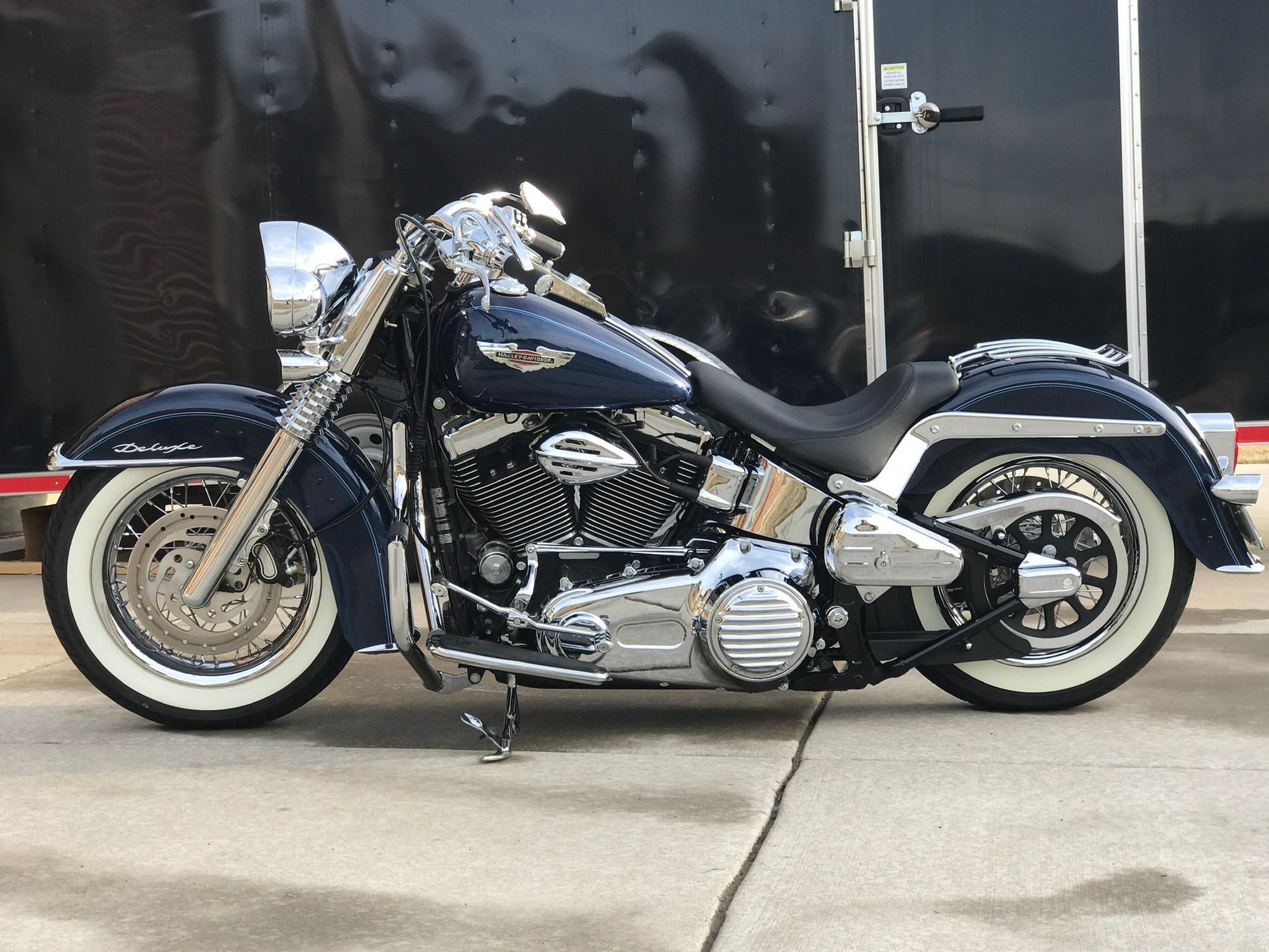

Hey All,
i did a search but couldn’t find a similar problem.
I have a 2012 Softail deluxe that has been stored for a few years. My problem is that when I turn on the ignition the fuel pump does not initiate and turn on. The bike tours over but obviously will not start.
Here is what I’ve found so far when I opened the tank top plate:
the plastic fuel line inside (PN 62189-02) the tank to the fitting on the bottom left of the tank was broken. I replaced ‘‘tis with a rubber fuel tube.
Then I noticed that the ROV to top plate tube (PN 62143-11) was also broken. I ordered a replacement today and should have it later this week.
My my questions are: would those lines cause the pump not to turn on because the lake of pressure? Is it likely the pump is also bad and Sould I replace the pump also?
