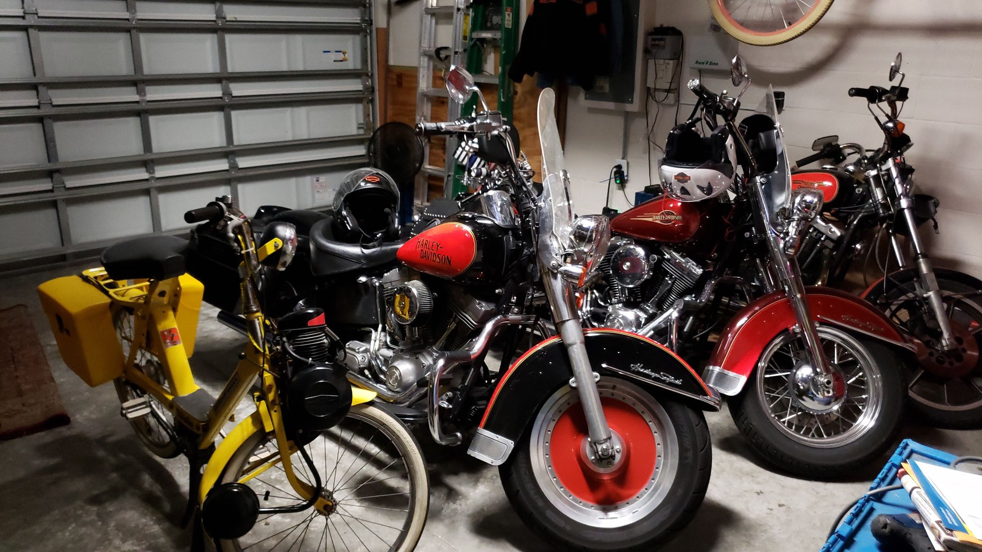

Here they both are. The one with the fatboy front is the 06 and the 08 has the Lace wheels. My wife loves hers.
