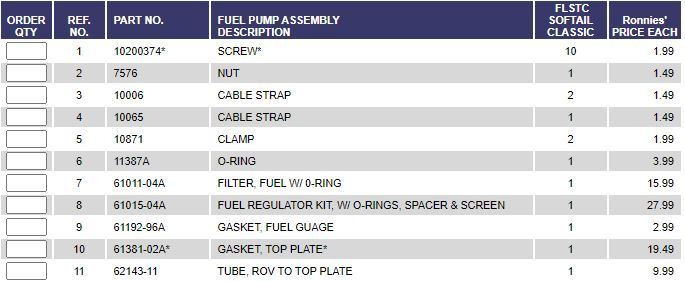

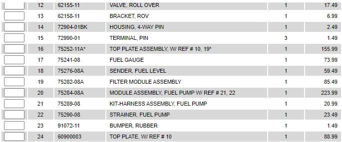

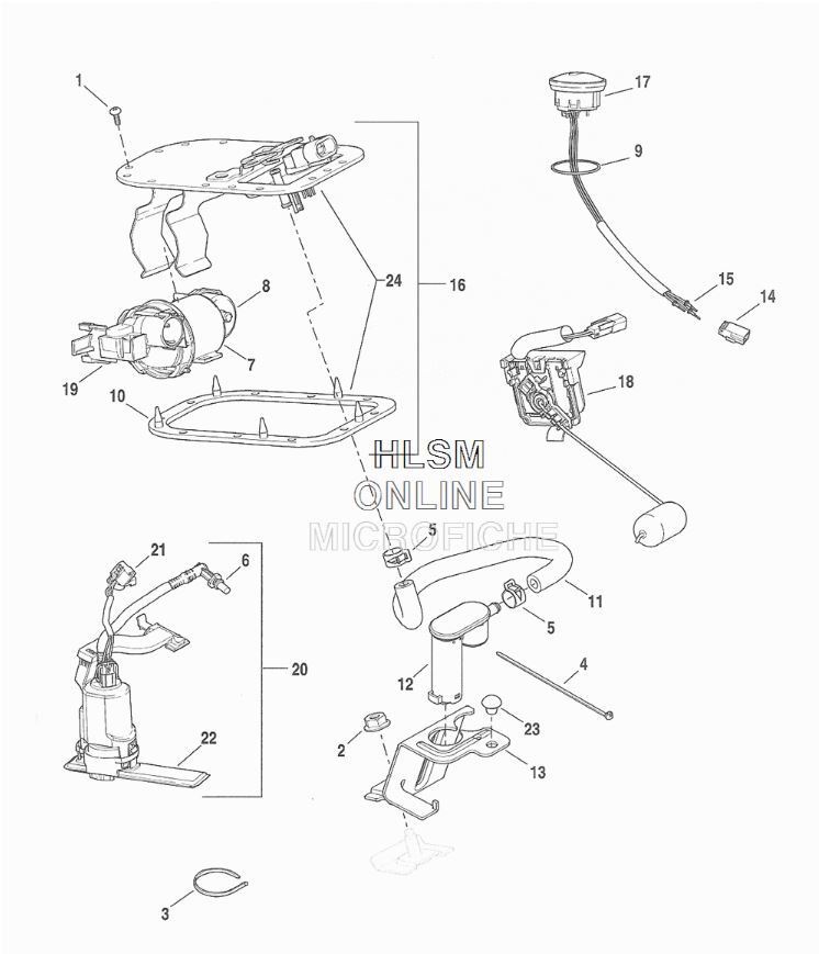

Bike is a 2012 FLSTC. I am changing out the fuel regulator housing in the tank and i am having a hard time trying to purchase the 2 fuel lines in the tank. The 2 lines are the check valve and the fuel line together and the other is fuel line that goes from the pump to the regulator. I have searched on line and the dealer is no help. Any help is greatly appreciated
I well understand...
I found the line from the tank to the intake here: https://www.denniskirk.com/goodridge...prd/188578.sku .
Then I located a new check valve assembly: https://www.jpcycles.com/product/100...y-oem-62189-08
While I am replacing the fuel filter, I do not plan to change the "other" internal hose at this time... hope that's not a mistake...
Searching thru the parts catalog (https://serviceinfo.harley-davidson....iew?id=273167#) I found H-D numbers and then googled away to locate other parts.
Hope this helps...
