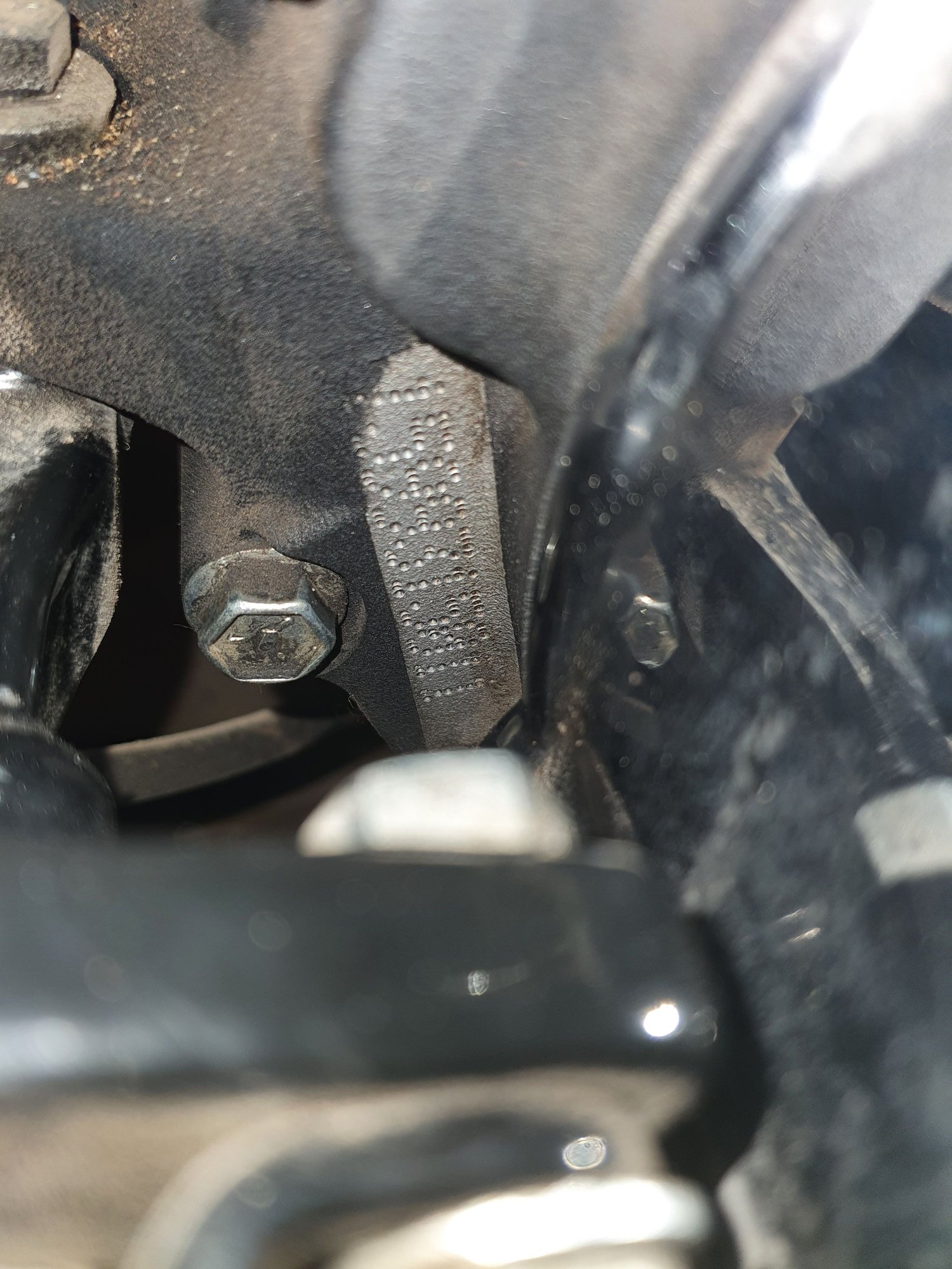

I’m not sure if it was confirmed about where the number is. I wandered out to the shed to take a look at my 99 and it is on the primary side right about level with the shifter linkage like the twinkies.

Thanks for that confirmation.. That's where I thought it should be... Been awhile since I've seen an EVO up close. I sold mine in the 90's
However, in one of his pics of that area, there doesn't seem to be an EIN......
Maybe it has custom cases...

Hello
I really am In a Jam I just bought a 97 Bad Boy in Germany and am now about to legalize it in Portugal...nightmare
Well I'm filling out the papers and see the engine vin has nothing in common with the vin on frame
Engine VIN ☆BMLX031161☆can someone decode please 🙏
the other number on cases behind gear shifter is 1599315011

EIN (Engine Identification Number) of BMLX031161:
BM = FLSTF, Softail Fat Boy
L = 1340cc (80") Evolution Engine
X = 1999
031161 = Production numbers- They should match the last six numbers of the VIN on the bike shipped from the factory with that engine.
It would appear that engine (or at minumum the left side case) was taken out of a 1999 Fat Boy (the last 6 digits of the VIN were 031161) and installed into your 1997 Bad Boy.
