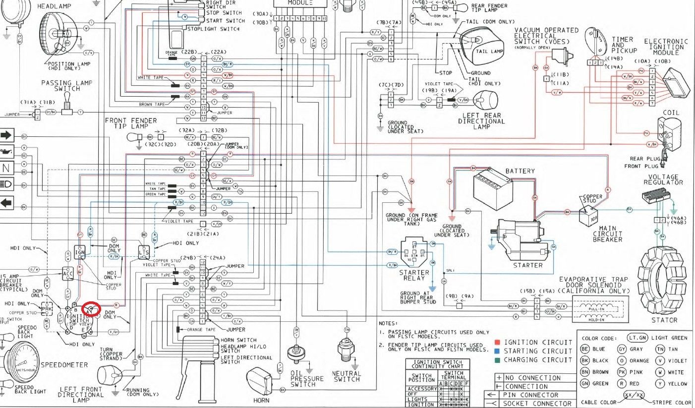

Read the voltage at the red wire on the ignition switch (circled in red) when the starter button is pressed.
10.16 when start button pressed, 11.98 when not pressed.
