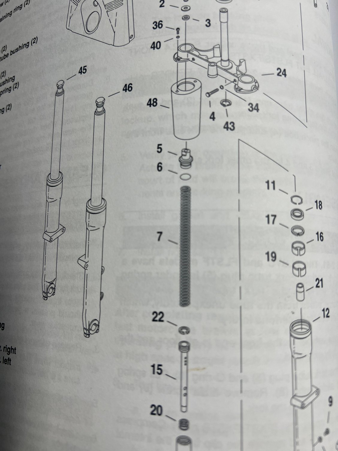

I had no problem loosening the 1 3/8 fork plugs by just lowering the bars a bit. My problem is there is another nut under that fork nut that has an external thread and an internal thread (for fork cap) and a rubber seal. #5 is the nut that keep the spring under pressure, the fork nut just dresses it up. You may be right and I just don't understand it.

I fully understand the difference between #5 & #45/46
If you would remove #45 and follow the directions above you would be able to access and loosen #5
Perhaps someone here has better communication skills and can explain it more succinctly
I understood your explanation
Thanks
Fork springs went in exactly like you described. Getting up to see the pinch bolts was impossible because there is a cable tie wrapped up in the tins across the bolts. Finally located the 5/8 bolt heads you described that I couldn't find.
