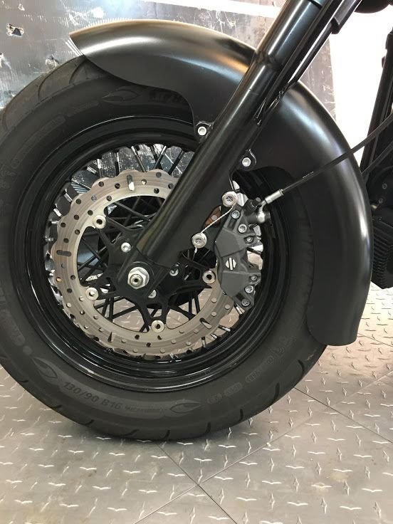

This is the route I chose since I also like to run the Heritage "hubcap" on my Slim. I used
a 4-pistion caliper from the XR1200 and a "contour" floating rotor from EBC.
T.
