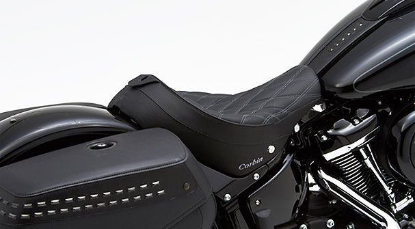

I know how she feels with the stock seat I could just reach the toe shifter comfortably if I scooted up just a bit. I put a Corbin seat on my Heritage, they built it 2 inches closer and narrower in the front, it is great. Call them if you are thinking about ordering one, it was no extra to have it made for me as they make them when ordered. I got the classic solo.
