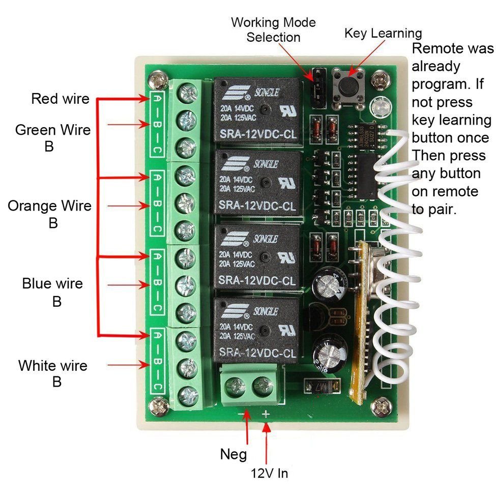

Default Shotgun Shock Remote Control
You guys that have a Shotgun Shock want to control your shocks via remote this is what I did. I bought the remote on E bay
https://www.ebay.com/itm/12V-4CH-Channel-Wireless-Remote-Control-Radio-Relay-Switch-Transceiver-Receiver/122036934849?ssPageName=STRK%3AMEBIDX%3AIT&_trksid =p2057872.m2749.l2648
Splice 5 wires into the shotgun switch harness, preferably the same color and gauge and run it to the transceiver box then daisy a red wire to the other A Slots. Then Run a 12v wire and ground wire to the box to power the transceiver, if you want to hide the box in the headlamp then tap into your headlamp harness for power. I put my box in one of my saddlebags so I went straight to the battery for power. Here is simple picture diagram, Just like the Shotgun switch I kept the upper left as Button A and lower left as C and upper right as B and lower right ad D.

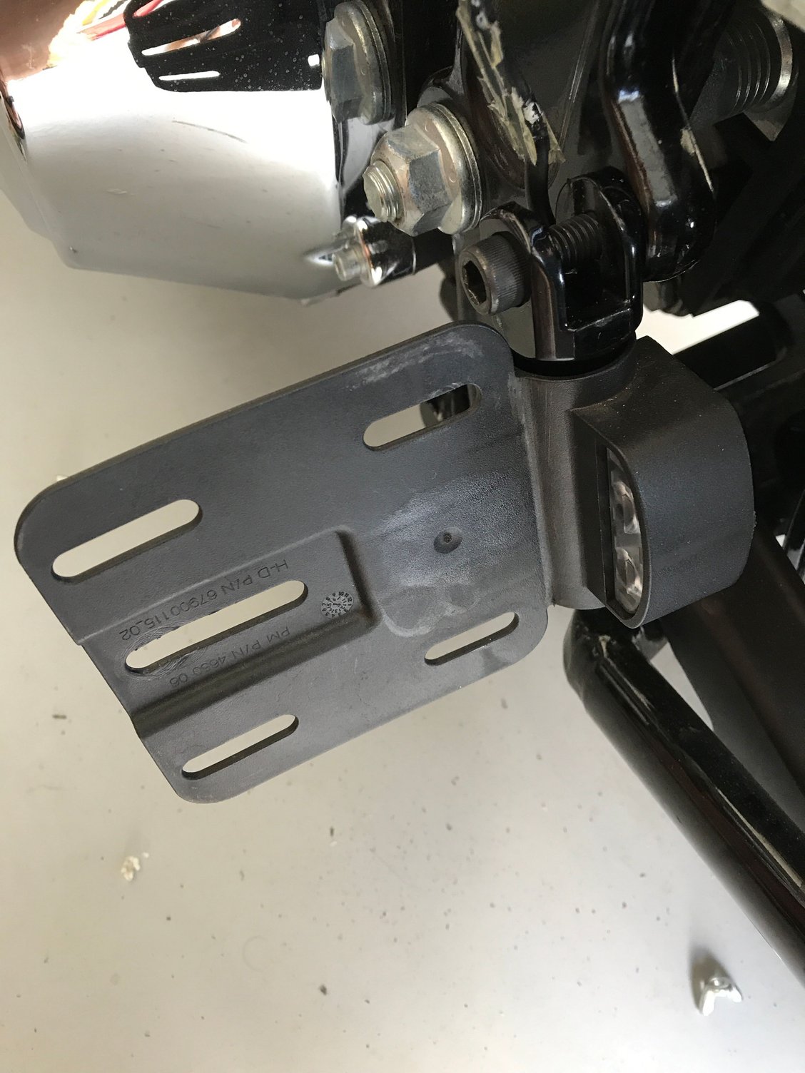

From: NYC
Originally Posted by kaisers81
Stock license plate holder + passenger foot peg mounting = side mount license plate holder
Any idea if this plate mount pivots in and out like the sportster plate mount? or is it solid/stationary?
