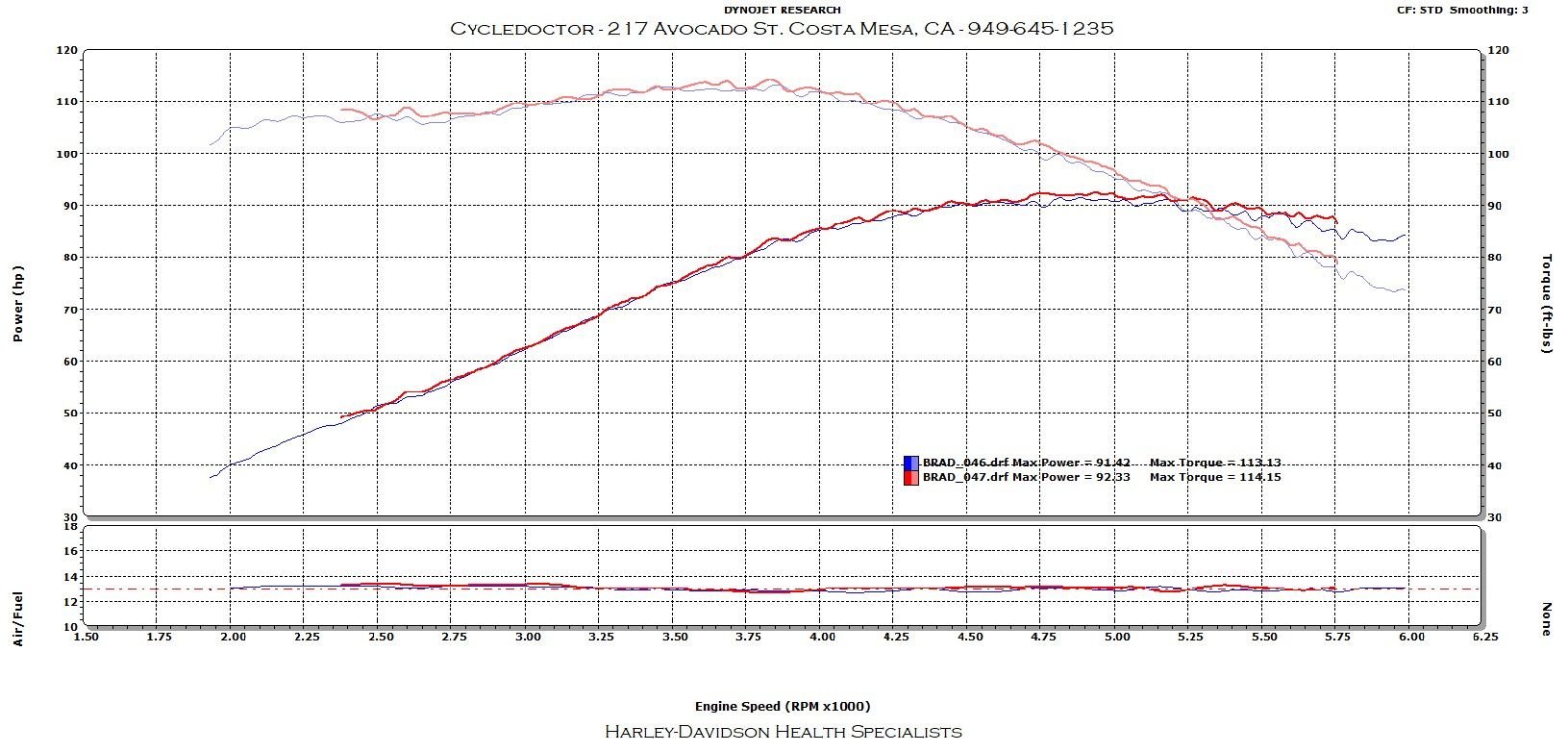

106 build, 585 cam, mild head work, and a D&D Bobcat.
I had hoped for higher HP but the engine runs great and the bike is a delight to ride. Prior to the build she had 75 max torque out of a 95ci. So much fun to ride around town and the canyons.

Which air intake are you using? Surely not stock?

Surely not...Performance Machine MAX HP. I am happy with her. the torque is instant and awesome, she does fade a bit at higher rpms, so just adjusting riding style a bit.

What compression are you running the 585's at? The numbers actually look like the 583 cams.
