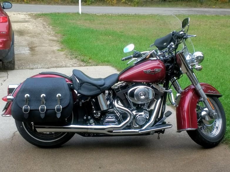

Default 2005 Deluxe
Bike had stock motor, stock pipes. Around 38K miles. Had Fuel Moto 98" Big Bore kit installed (link) using Superttrap Supermeg 2/1 pipes with 19 discs.

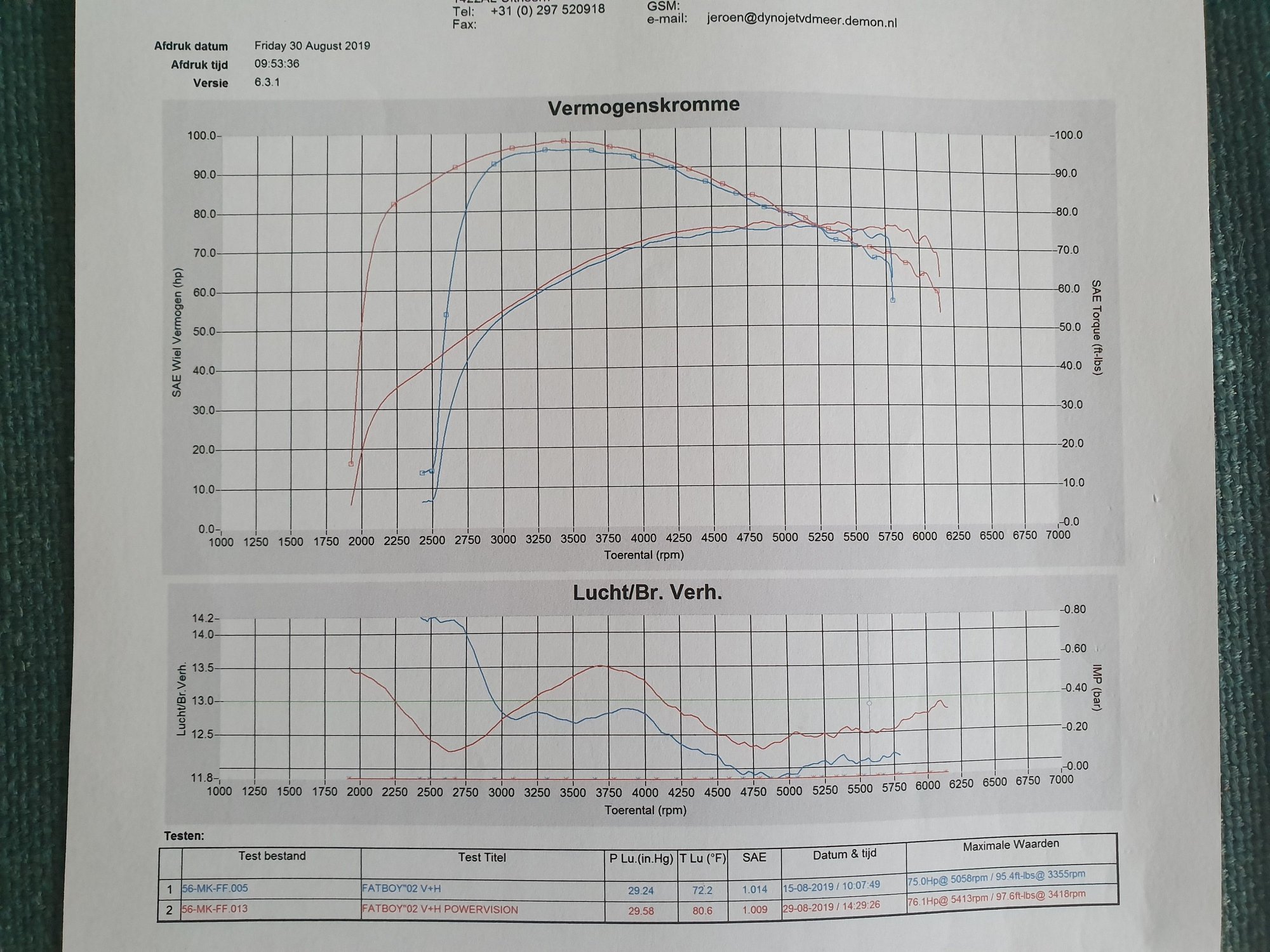

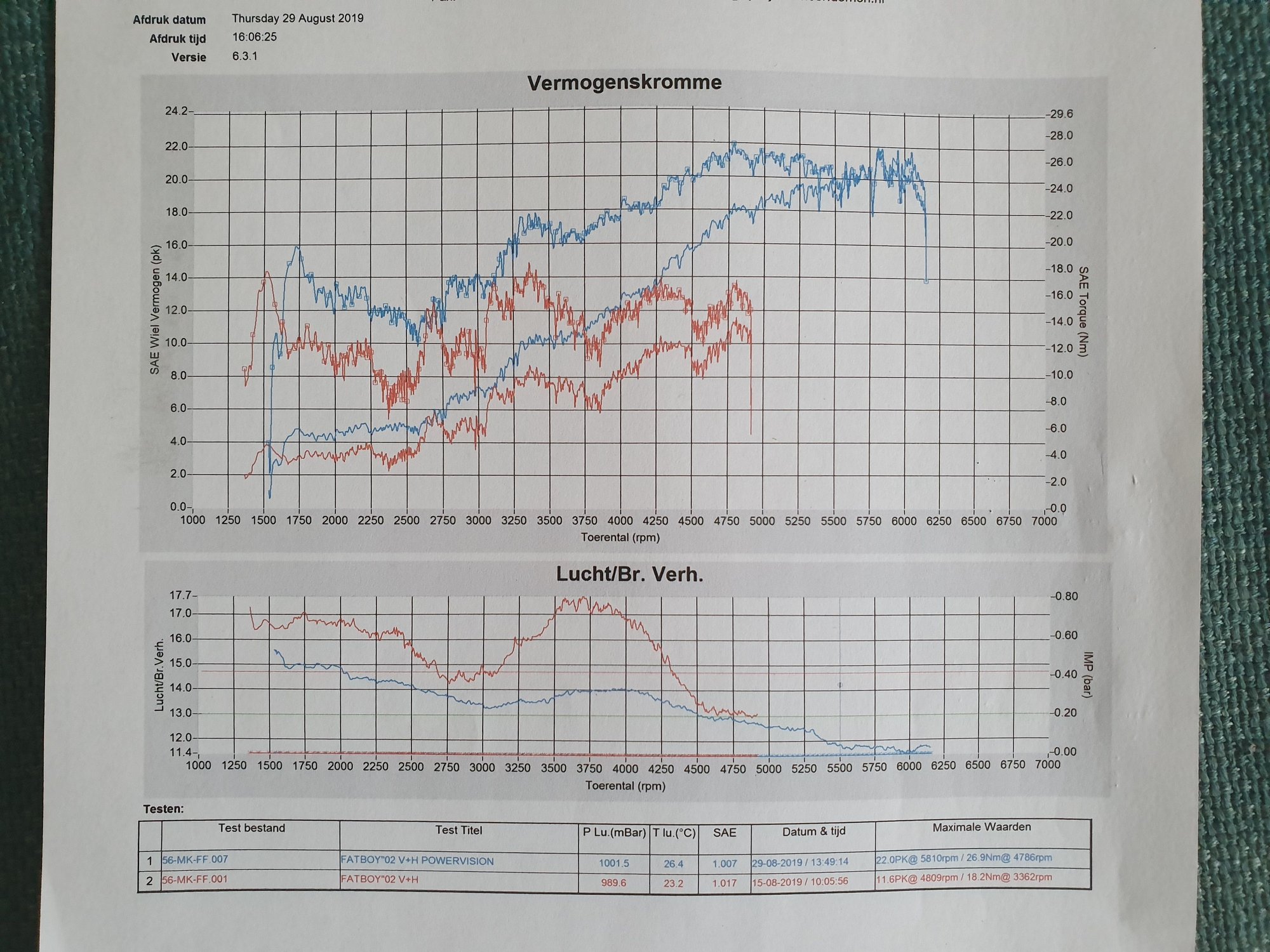

Default Fatboy 2002 EFI
SE 203 Cams
SE A/C with K&N filter
V&H 2 into 1 Pro pipe with quiet baffle
Tuned with Power Vision
I think the rest is stock but haven't checked if it's still a 88 and not a 95 or so?!
WOT shows 97.6ft-lbs @ 3,418rpm and 76.1hp @ 5,413rpm but the real benefit of the tune was at cruising when the bike was running waaaay to lean as you can see in the second picture.

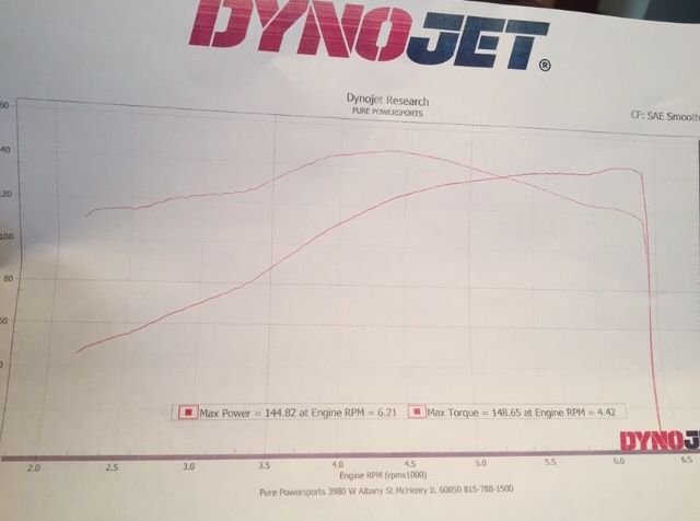

Default 144hp/148tq
Revolution 117, 11.3:1 CR, 640 gear drive cams, HPI 58mm, Ported Heads/Big Valves.
