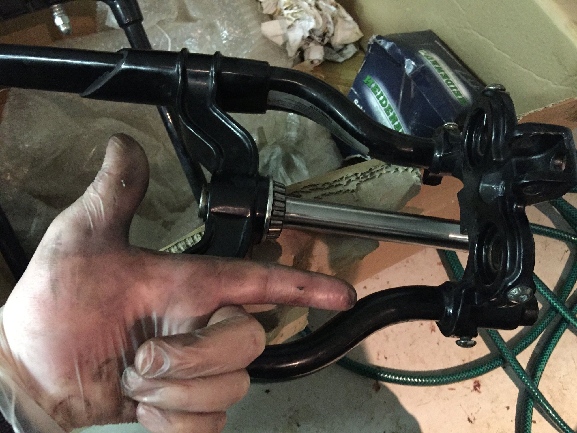

So I installed the Vulcan kit on my Crossbones, but had problems with the handling on the test ride. Bike felt like it was steering itself with jerky movements if I wanted to head left or right. Felt like it was dragging. Talked to the guy at Vulcan and he told me the springer perch might be in contact with the neck. Took a look and sure enough it was.
Got a carbide dremel bit and with a bit of work trimmed a channel on the neck side of the springer perch. Now it rides great!
Will post a pick of the initial cuts manana...
Here's the dremel cut before it gets cleaned up.

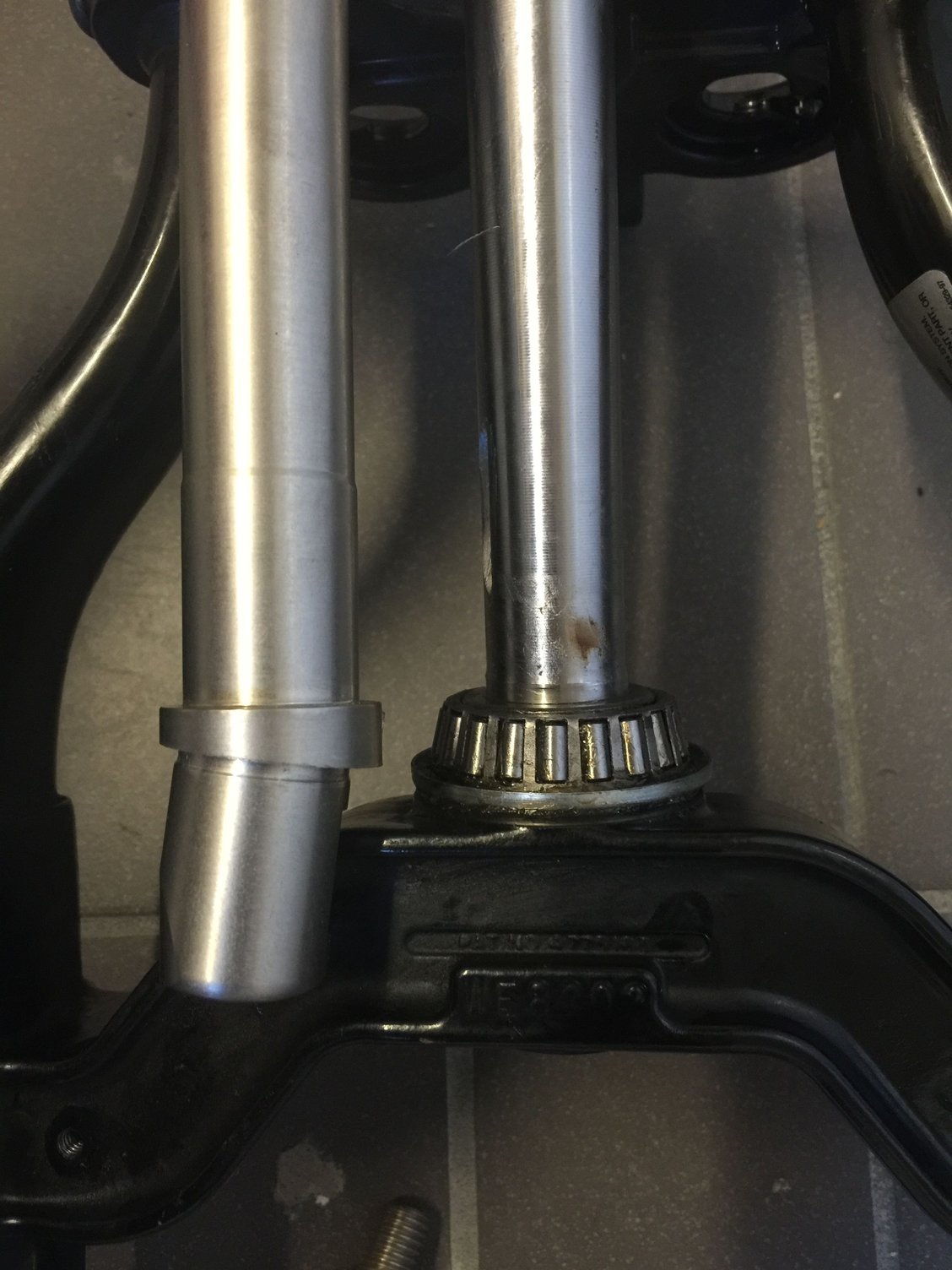

It took a couple of years since I bought the kit but now it's finally underway. Spent a couple of late night hours in the garage taking the fort off the bike.
A couple of questions; when it's time to press out the stem - it goes upwards, right? Towards the triple tree? Any tips on how to set it up in the press? Use a jig?

The stem goes out that way right?
No - The other way. Heating the lower surrounding and supporting the fork assembly on a 1 1/2 inch pipe helps when you persuade the stem out with a 3 pound sledge like I did with mine.
Old Feb 26, 2016 | 09:26 AM
  #169
Pelleman's Avatar
Pelleman
Joined: Oct 2012
Posts: 20
From: Sweden
Ok, good to know before I start banging... Looking at the Vulcan stem it seemed logical that it would go out upwards. I guess they are different (duh?).

Yes, the snap ring on the bottom of the stocker which does not need to be removed is what throws you off.
