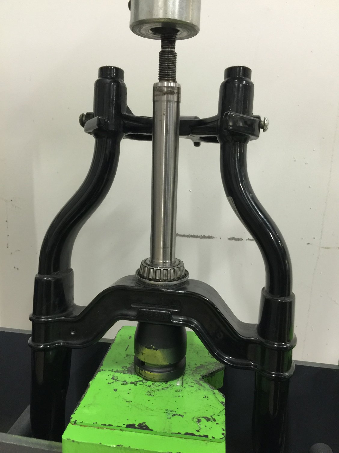

It took a couple of years since I bought the kit but now it's finally underway. Spent a couple of late night hours in the garage taking the fort off the bike.
A couple of questions; when it's time to press out the stem - it goes upwards, right? Towards the triple tree? Any tips on how to set it up in the press? Use a jig?

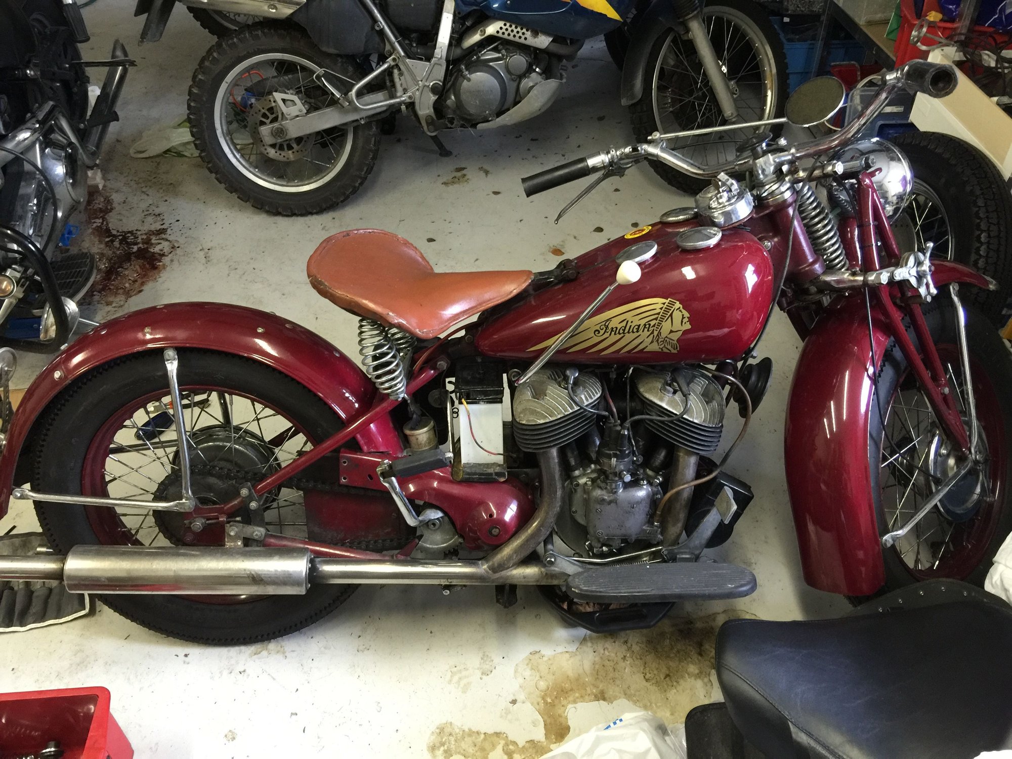

Yup, it's an 05 Classic. I gave the stem a couple of whacks with a sledgehammer and it didn't do anything except to ruin the threads so now it's a no return operation. A friend who works at a local power plant is going to help me as they have a state of the art workshop.

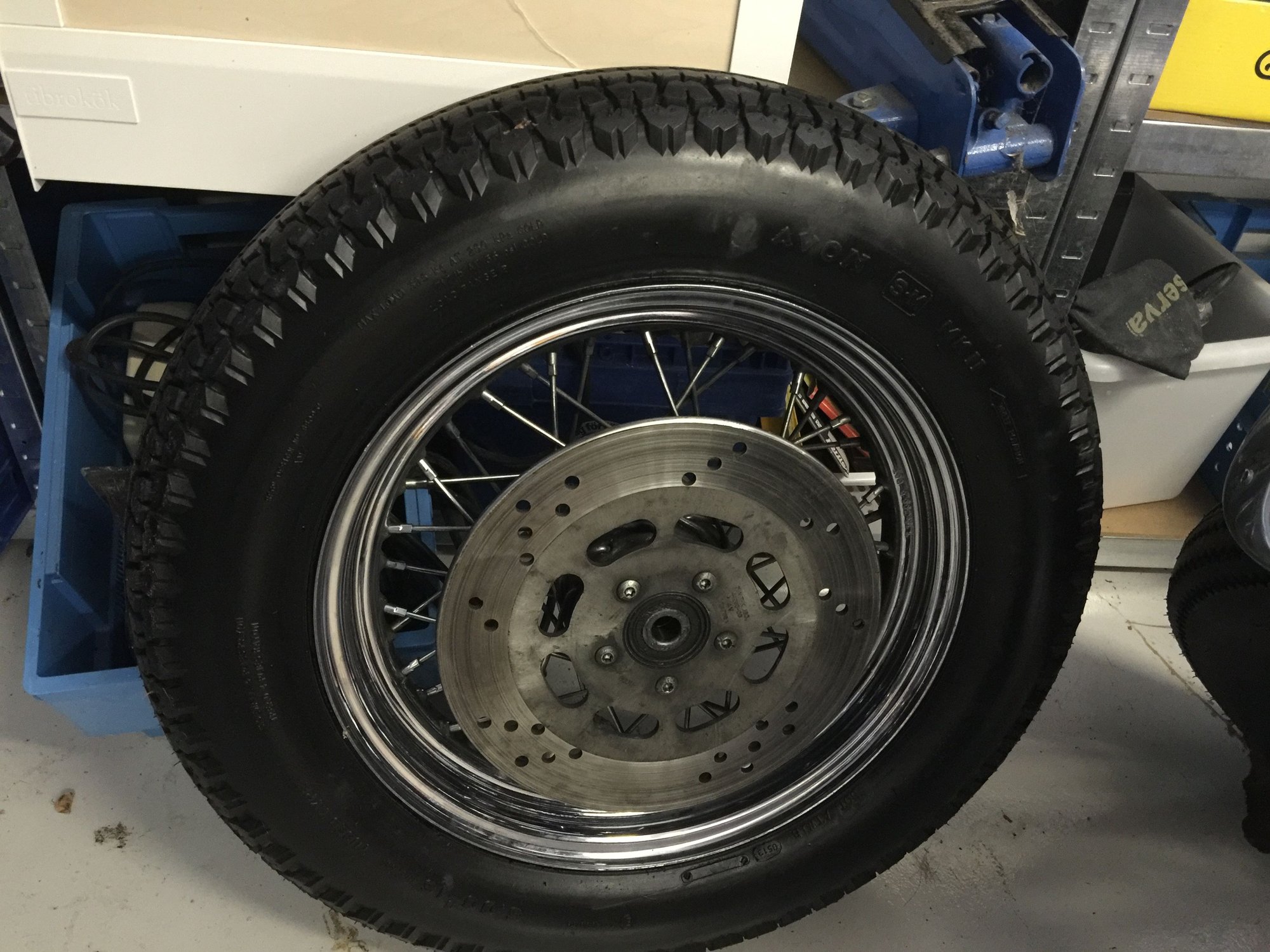

Here'a pic of the current status. According to international law, the only tires allowed on a bobber is the Avon MKII and Firestones. The Springer is getting Avons and its buddy Tonto rolls on Firestones...

just a bit trivia ...
That Front Brake Rotor is somewhat unique...2000-up Springer only.
Has the appearance of the everywhere-everyday 1999-earlier brake disc, but with the 2000-up larger ID hole for sealed bearing hubs.
That's why the "-00" part #

Tonto is gorgeous !

Here we go!

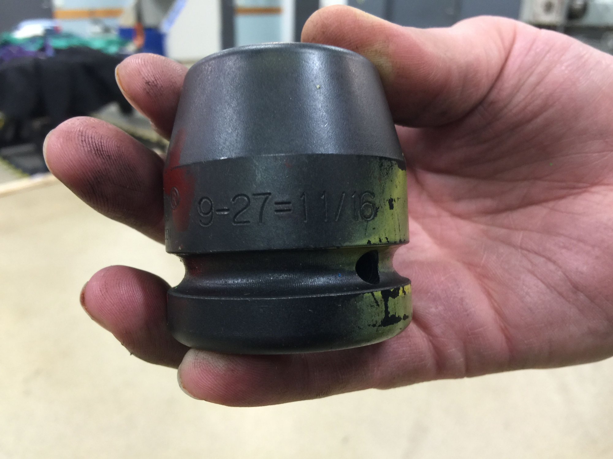

For furure reference. There's an angeled area on the bottom side of the fork so that you can put a socket or a pipe to make the stem line up in the press. If you do it wrong it'll bend or snap.

As you can see, the area surrounding the stem hole is angeled. That's where you have to put the support.
