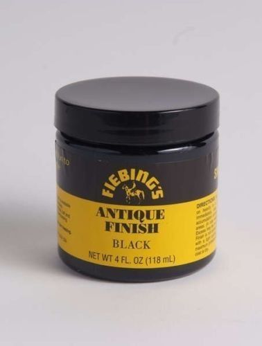

Yes there is a spicific way to do it, first you need to seal the leather, did your seat come nude, raw ready to dye?
Otherwise you use a sealer like leather balm, it gives a slight sheen and keeps the antique from going into the parts you do not want to dye.
The antique is like a shoe polish wax, very thick.
After the balm you put it on with a paint brush, let it set then buff it off with a rag leaving the areas that you want black.
Do not use regular leather dye it will soak in and not rub off.

This.
http://www.ebay.com/itm/Fiebings-Ant...item25741e3119

Thanx bro, great info. I will give it a shot. There is a shoe repair place in town. I bet he has that stuff there. Anyway, thanx, I will post pics after I give it a shot.

That wont work, liquid dye bleeds and it will not wipe off once it is on the leather especially if the leather is not sealed.
Shoe paste might work but you still need to seal the leather.
