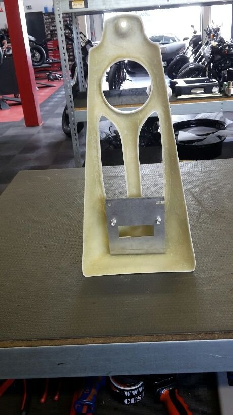

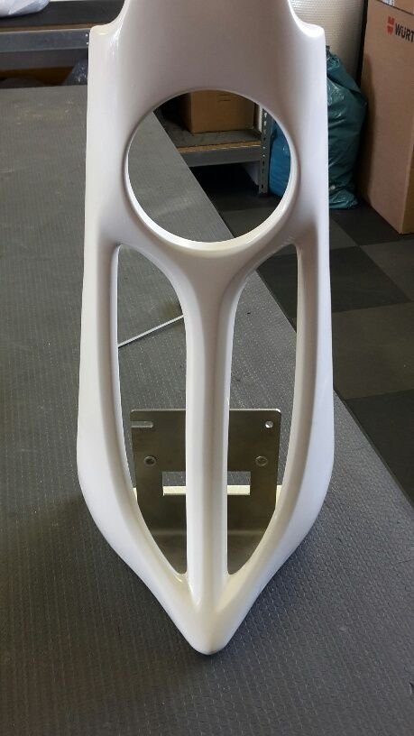

Default chin spoiler
Found a killa chin spoilers made by No limit custom
http://www.no-limit-custom.com/produ...tail_breakout/
heres a shot of mine with photoshopped spoiler and without plus a couple of the ST 1020 spoiler

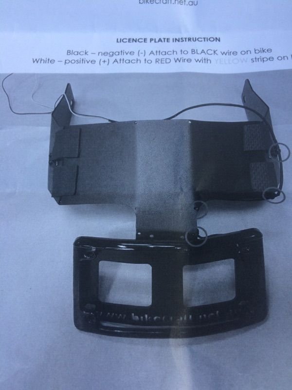

Default breakout Tail Tidy fender fix
heres another tail tidy from down under not as sharp as chopz but half the $$
http://www.bikecraft.net.au/bikecraf...eakout-2013-up

That spoiler is going to be a negative in stop and go city traffic . . .

Why Jim ?
Poor airflow over front cyl ?
i have a oilbud cooler

theres this one ST1010..more airfow

At low city traffic speeds, it's not airFLOW (you are sitting still a lot, not moving at all), its heat RADIATION that is cooling the 2 cylinders as best it can. The spoiler interferes with that radiation - it gets in the way of any air convection that you might at least otherwise get because of the temperature differential of the hot air right by the cylinder versus the cooler air right below it.
The oil cooler is not much help either when there is no, or very low, forward speed.
I think it is unwise to do anything that degrades the already very marginal cooling of an HD engine. That engine needs as much UNobstructed access to air as we can possibly give it.

See my last reply above. There IS no airFLOW in stop and go city traffic.
