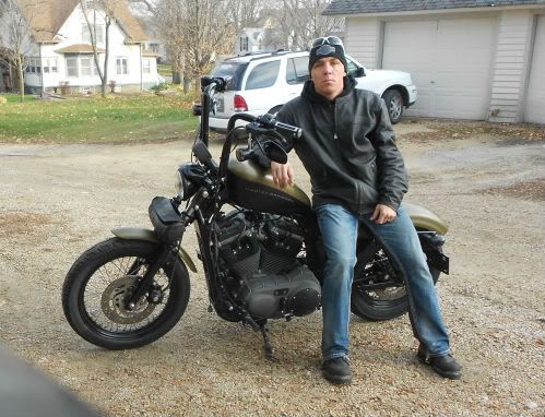

I have 14" Apes on a 1" riser and am 6'1" they pretty much sit at my shoulder height wise but are VERY comfortable on long trips.
This is me just sitting on my bike
