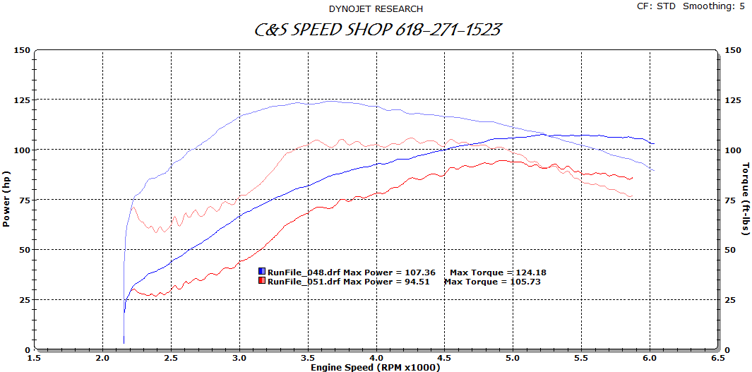

Here is a 2012 CVO 110
Kury 24D
VH PD and Bassani slip ons
The difference between these two runs is one of them have the baffles removed. But according to the math:
2500 x 100 = 250,000
3000 x 100 = 300,000
3500 x 100 = 350,000
4000 x 100 = 400,000
4500 x 100 = 450,000
5000 x 100 = 500,000
5500 x 100 = 550,000
6000 x 100 = 600,000
is for both of the engines combo's. If both engines combo's are flowing the same amount of air and both engines combo's have a lambda of .885. They would be putting out the same power. BUT in the real world where you back up theory with testing. We see that they can not have the same amount of airflow between these two combo's.
