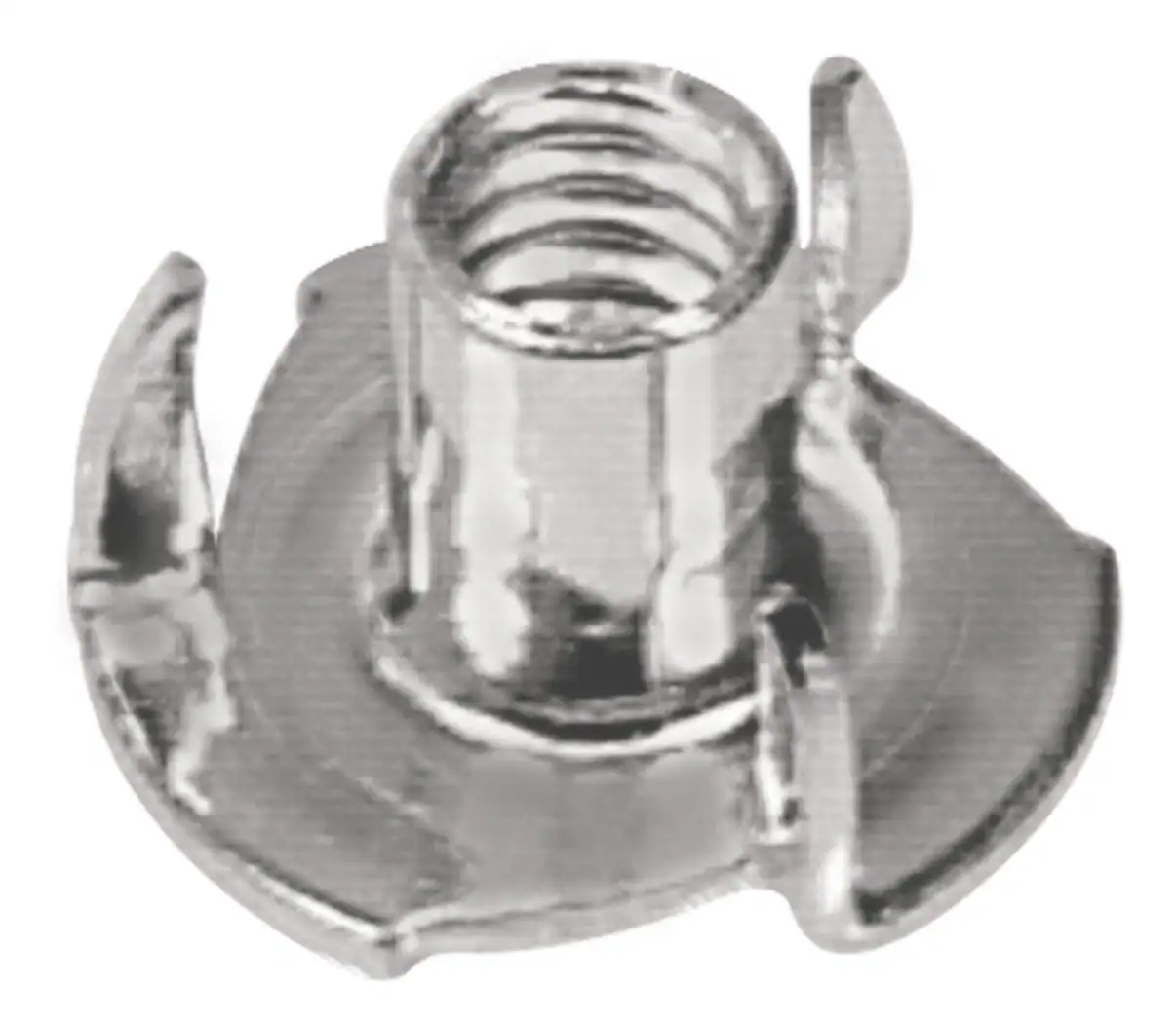

assuming your trailer deck boards are sound 'n solid, something like this.
you'll only have to climb under the trailer once
3/8" and stainless
https://www.lowes.com/pd/Hillman-3-8...E&gclsrc=aw.ds
3/8" and stainless
KTF
This is pretty cool. I wasn't sure if I would need a plate or giant washers. I was thinking of screwing a plate underneath. I think my chock is set up for carriage bolts. I have to look. But this would require crawling underneath to tighten, not big on that. This is a cool option.
Welding nuts on a plate is another option. But I have never weld. I like this. The chalk is taking a lot of force, the straps are. But want to hold it while I get it set up. I am surprised no one sells a chalk that comes with a bottom plate.
So do start these nuts by hand, and then tighten bolt, sucking them into the wood?
3/8" and stainless
KTF
I use four 1/2"-13 t-nuts to mount a winch to my car hauling trailer. The trailer is exposed to the elements, so I remove the winch and bring it indoors when not needed. Once installed, the t-nuts eliminate the need to hold a wrench from the underside. FWIW, I've used the winch to drag a full size pickup with four flat tires up the trailer. As long as the planks are solid (not rotten), the t-nuts are an inexpensive alternative to plates, large washers etc. that to be held in place from underneath.

Originally Posted by Rounders
ISo do start these nuts by hand, and then tighten bolt, sucking them into the wood?.
correct
If deck boards are weathered bad, screw a piece of new board to bottom as a plate
when chock is off, run the bolts back in and leave them there.
Two reasons for that
1.) you won't have to go looking for bolts when you want the chock back on
2.) you keep gunk/crud/dirt/mulch/etc out of the holes
as far as chock cut for carriage bolt (you mean square hole?)
no biggie, you can still use a hex bolt and washer
as far as securing the bike to trailer, I had the HF chock you linked.
just me, I'd install I-bolts thru trailer (thru steel crossmember would be best) and not secure bike to chock I-bolts alone
I-bolts thru deck are unobtrusive enough to leave permeant installed .
