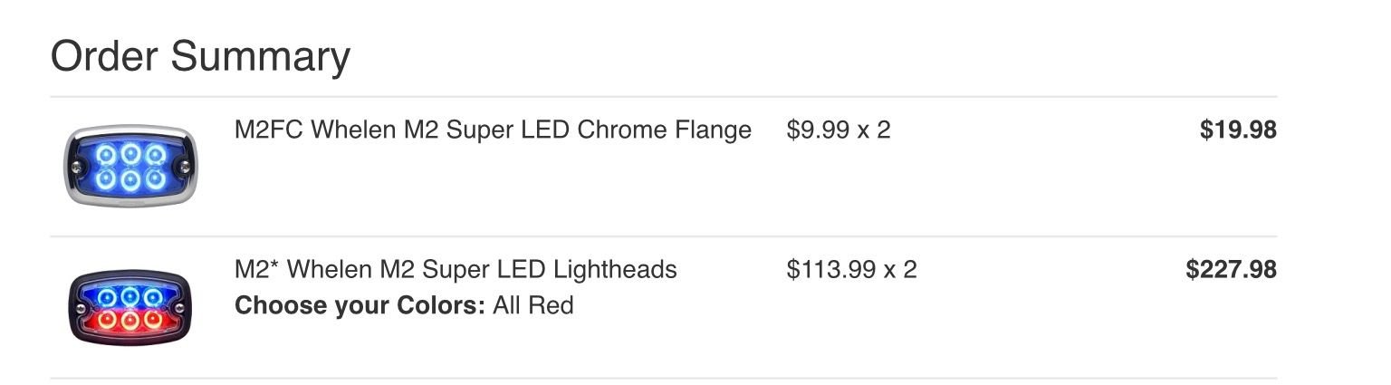

4) The Reds on the rear fenders replaced the factory reflectors, are Whelens...kind of expensive...but extremely bright and high quality.

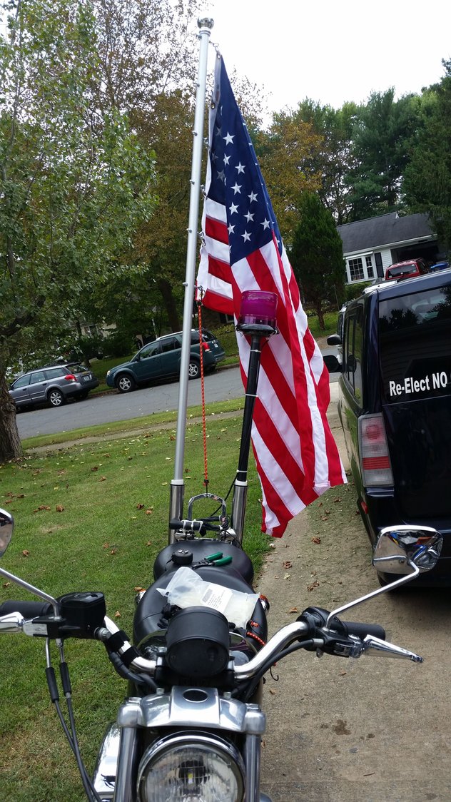

I use a roof LED strobe on a 3' black pipe pole in one of my flag holders. Here in VA purple is for funeral escorts, I have an amber lens for other uses.
