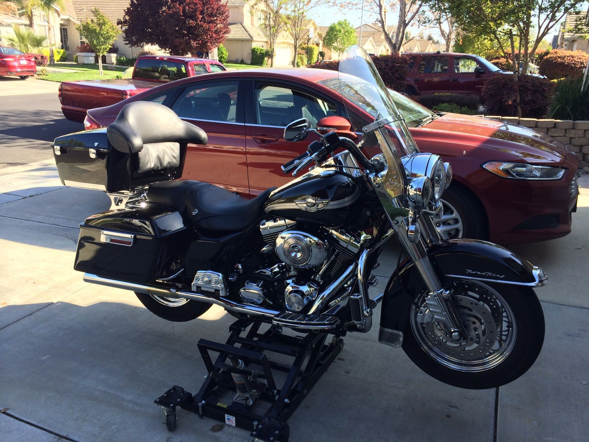

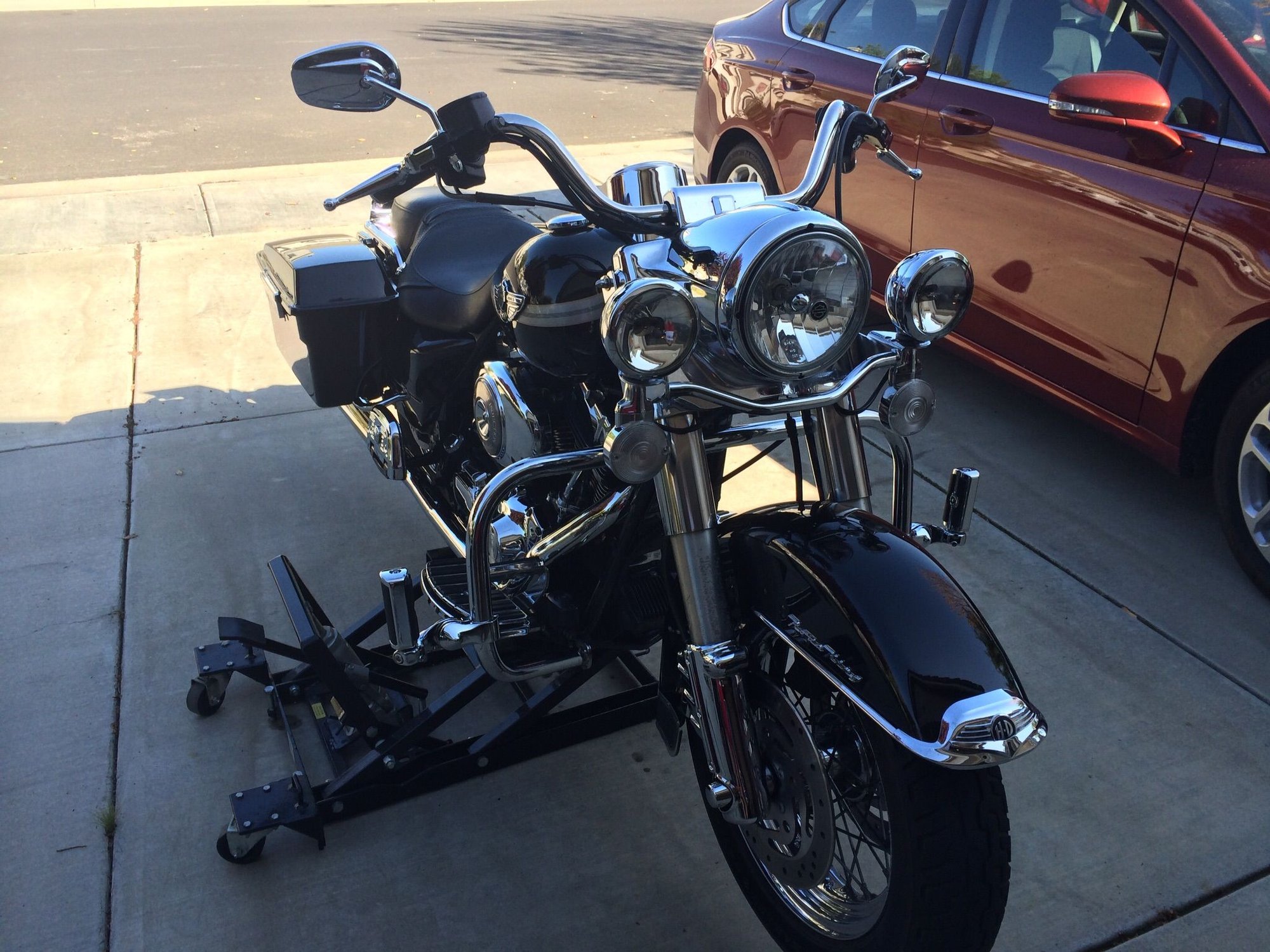

Just because pictures are cool!
New rotors
Around town style
When my wife comes along...
