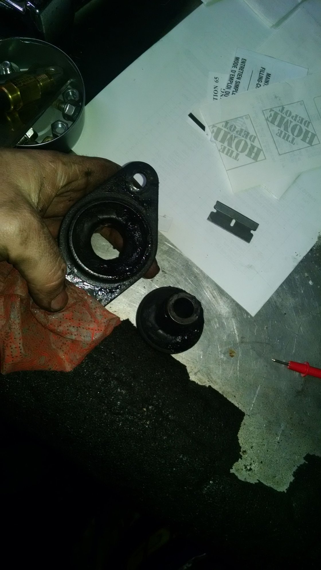

That was my motor mount.
Very common for your year bike. The replacement HD part is supposed to have better materials, but I'd suggest you get the True Track system for front at a minimum, but if you dont already have it, rear too.
