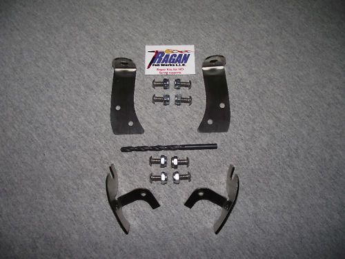

http://www.ebay.com/itm/Fairing-Supp...PHjeQw&vxp=mtr

I bought that repair kit on ebay, works great.

put these sets on about 5 bikes. works great and is nice and strong. would certainly recommend them for those that don't want to make their own
