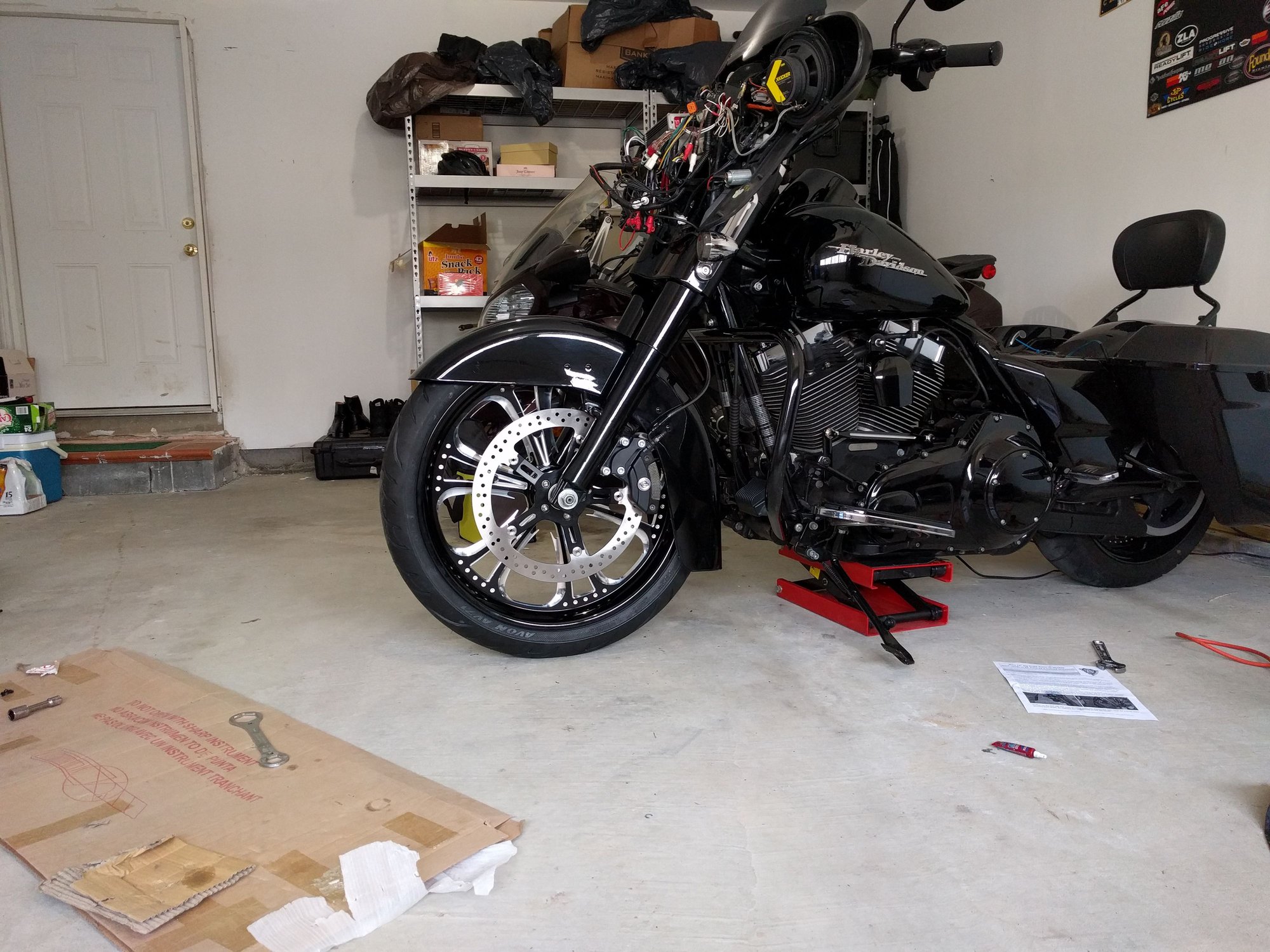

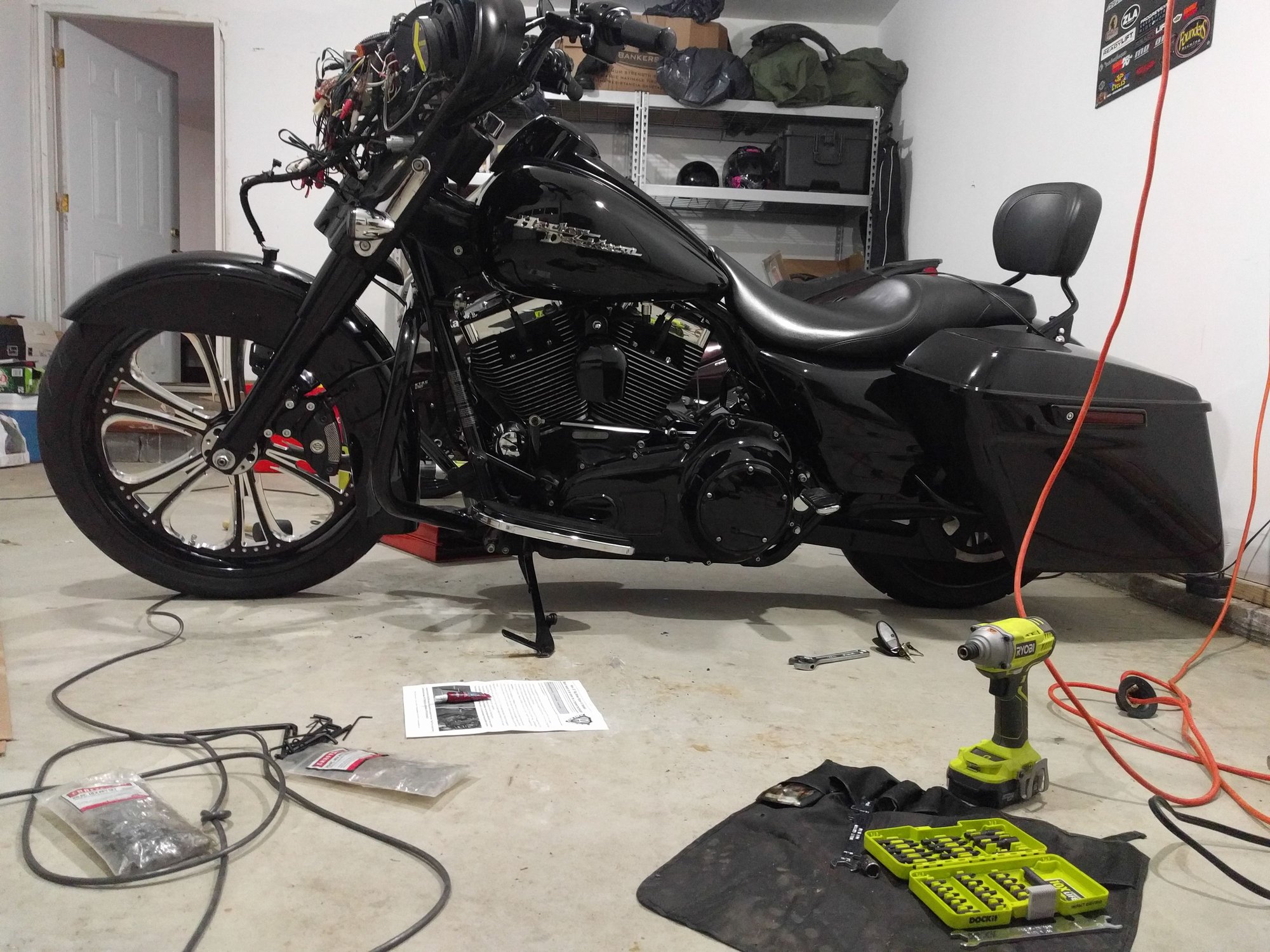

So I got my new wheel, just waiting on new rotor bolts to put on the arlen ness 14" rotor. I lowered the front end an inch with progressive kit. The tire on this one was a little taller, so it actually seemed to sit higher and made the drop level it nicely. I had to drill out the back holes of the fender to give the tire enough clearance, made sure there's an extra 1/4 inch space for tire deformation at speed. Got a back rest for my wife. Took off the stock mirrors and put some handle bar ones on.
Didn't realize before that everything on the dyna brake master cylinder was different, so had to get a new lever and am waiting on a 12mm banjo bolt and fitted, hopefully everything will be here Friday, the weather is getting nice and I can't wait to be riding every day.
Side to side you can how much of the tire was not getting used with the incorrect set up and with the lowering springs , I'm assuming my low speed maneuvering should be what it is supposed be, it felt a little unstable but it did have a wrong tire/wheel combo and sat an inch high in front. I'm excited to try it out.
Changed the brake pad to ebc hh as well, should be more than adequate with the single 14" rotor for now.
Kind of alot to change for a bike I just bought, but I like to have confidence in my machine. Luckily I have people interested in the other wheel, so it should make up for buying the new on pretty good.

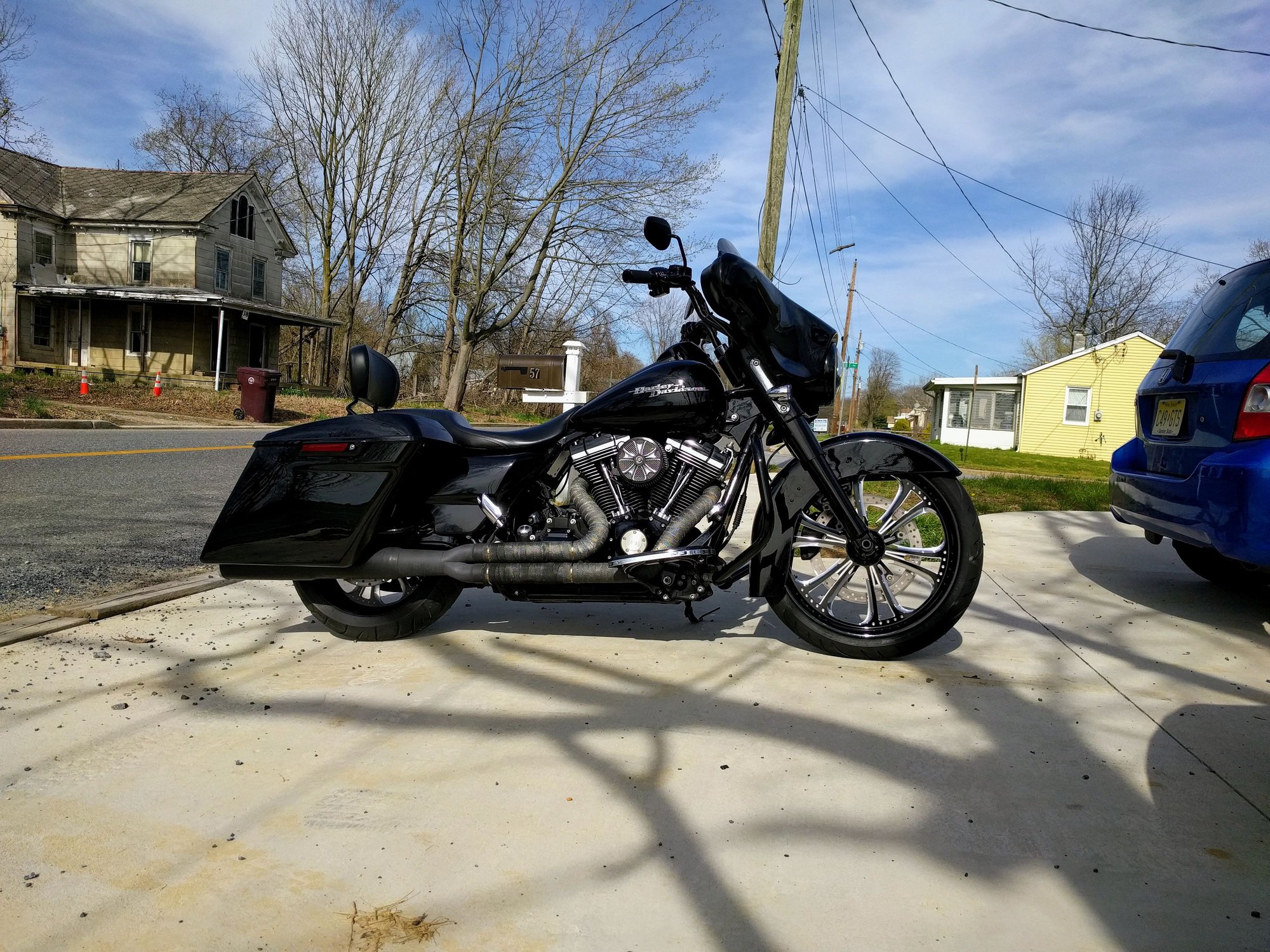

Yea I guess not lol, anyway my bolts came early, wasn't really expecting them until Friday. The bikes rides so much better now with the 1" drop and correct wheel/tire. Once I swap that brake master cylinder I'm good to go for a while. I gotta stop ordering stuff haha.
