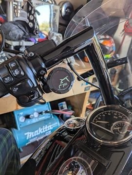

Default compact navigation system Beeline Moto II
New farkle!! I have mentioned that my RKS replaced my 05' Electra Glide and serves as my touring rig. I do several 2K plus trips a year on it plus a few shorter trips. I do think the RKS makes for a great touring rig without all the weight of a batwing or sharknose fairing or the high and heavy load carrying of the tourpak. Anywho,
I use a Tomtom Rider 550 GPS on my RKS and really like it. Occasionally it does some odd stuff with directions or my Bluetooth, but tech will be tech. I also do shorter overnights on my Vespa. (feel free to insert joke here) I recently got a new navigation unit for my Vespa, the Beeline Moto II. It is not a satnav but rather relies on an app to function. I won't go too much into the differences here but thought some here might like the idea of a very stripped down navigation system which is a big part of the Beeline Moto's deal.
I used a Ram 1" 5/16-24 thread ball to attach it under the mirror stem. I used a 5/15-24 nut to replace the acorn nut so I could get the right torque and feel more secure about the mount. Then I put just a dab of blue locker on the ram mount and snugged it down. It believe the Ram ball is aluminum and not steel, so I did not trust it alone to hold all the stuff there together. From there, it was a short Ram arm attached to a Beeline Moto 1" ram ball mount.
I think it turned out pretty clean looking and will use it to supplement my Tomtom on rides since the two units can be set to display different data. If you have ever thought about using a dedicated satnav or didn't want to risk your phone on your handlebars, I really suggest giving the Beeline Moto II a look. I really think it complements the stripped down look of the RKS.

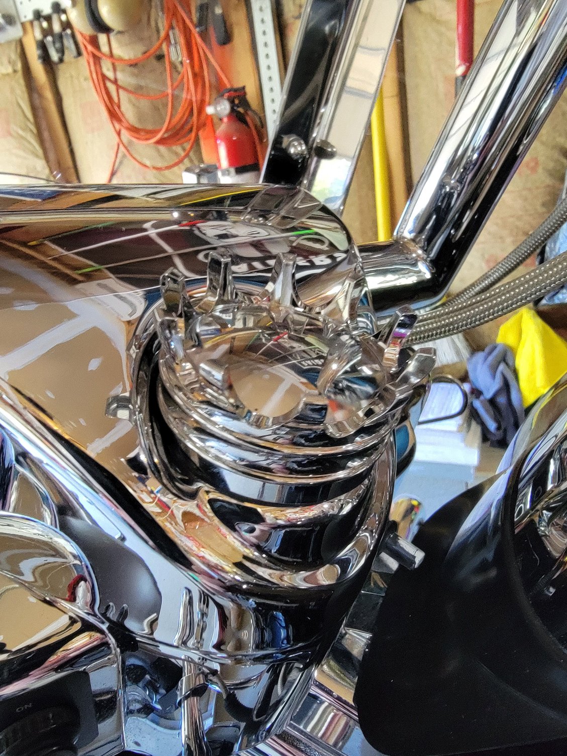

It's the little details........

Ditto

agreed!!!

Nice decoration, but personally I would prefer to install an outside temperature gauge...

Bro!!! That's freakin badass!!! Custom made I assume???

They have those as well but the vendor I got my crown from sells out of them. The best way to tell the outside temp is if your beer stays cold in the cup holder while you are riding.
