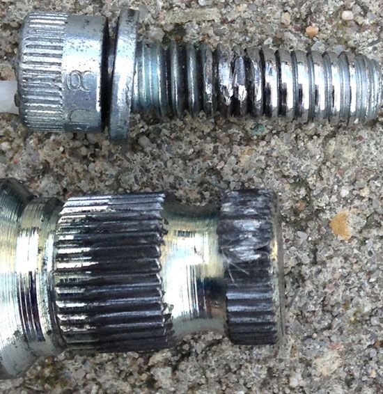

I find no need for the heel shifter. Awkward trying to use it. I admit I bang the shifter some times downshifting. 95% of the time I drive the bike nice and the other 5% I drive it like I stole it.
Here's my spline shaft and the screw. The screw I bought with the new shaft was longer the one I posted. No play in the shaft now. The screw keeps the spline in place in the bevel area. If some one takes the shaft out and puts it back in and the screw and bevel not lined up would probably cause the damage above. I bought the bike with 2300 miles, 2014 RK. I sold my wide glide, my springer, but the wife wouldn't let me get anymore bikes til I sold them all. The last bike I sold was a 1942 WLC with side car. Hurt so bad, but she's the boss. I know who has it so I can ride when ever I want.. Looking for a 70's Triumph now.
