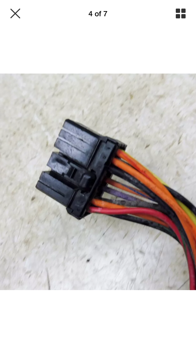

Default I really messed it up
Is t
Does anyone know if there is there a way to get the wires out of this connector so i can insert the new bullet ends of the new SPKR switch into the connector?
Old Oct 14, 2017 | 03:33 PM
ORradtech's Avatar
ORradtech
Joined: May 2015
Posts: 2,172
Likes: 377
From: Georgia
Originally Posted by TexXAzz
Is t
There is a way. I found it in the FSM. There's a whole section on the different connectors used in the bike. Not near it now though. There may be special tools to make it easier but I've always made do with bits and pieces around the garage, wires, picks, paperclips, micro screwdrivers, etc.
