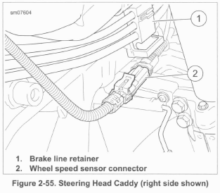

Originally Posted by clackavosticus
This is the offending connector. When I took the tape off it had separated but I put it back together for this picture. Instead of using tape this time I am going to cable tie across the plastic clip parts - hopefully that will keep it from separating...
Damn that thing is nasty.

Posts: 3,492
Likes: 610
It should be the connector for the front wheel speed sensor. If it became disconnected I guess it would cause the ABS & Linked braking to revert to standard braking.
Thanks for the clarification ..... Also, if it became disconnected, the ABS light would be on solid while riding ....

By looking at the picture, is that Wheel Speed Sensor Connector supposed to slide onto and lock into the Brake Line retainer instead of just hanging there?
