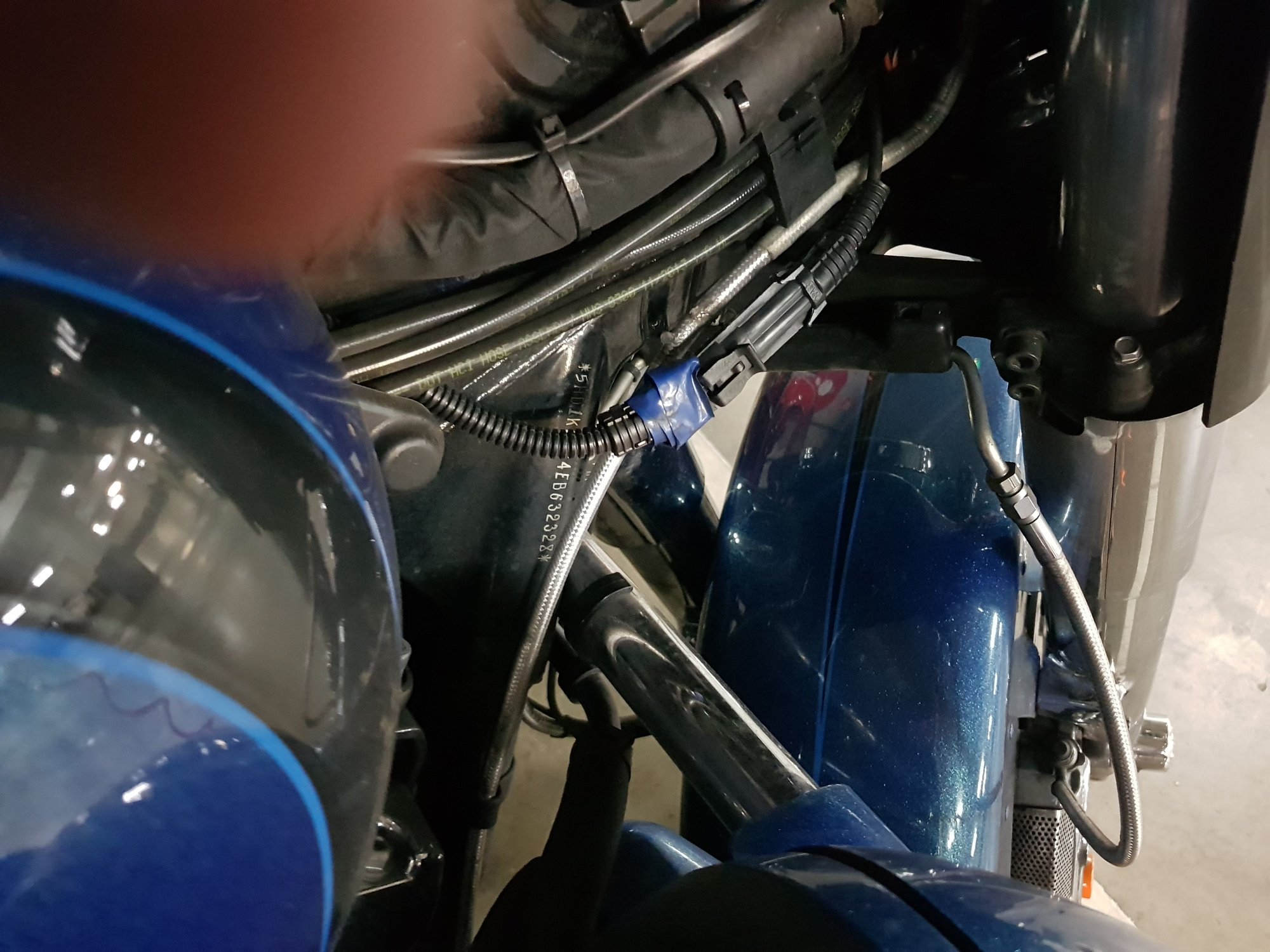

Question Do I need to worry?
On my 2014 FLHTK tourer there is a wiring loom running along the neck beneath the tank on the Right hand side of my bike, running toward the rear.
One of these wires has a connector. The thing that has me worried is it looks like the connector is coming apart.
Has anyone ever had this connector come apart on them - or is the looseness just my imagination?
What function would I lose ie what would be the electrical symptoms if this connector were to come apart?

The two halves male/female appear to be separating - pins seem OK.
I've pushed them together but the latching plastic tabs don't seem to hold on to each other properly....

Post a pic, if you can.

Old Dec 20, 2017 | 06:02 PM

I've never seen anything come out of the factory with that sloppy blue tape on there. Kinda makes ya wonder what's goin on underneath that stuff. Might be at least part of the answer.
