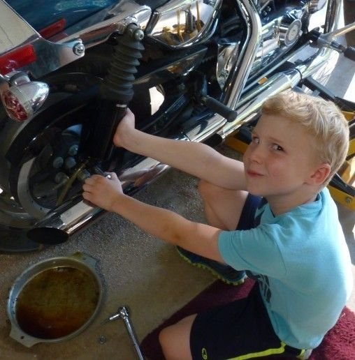

My grown daughter and I put about 390 lbs on the seat, with the tailbag, somewhere over 400lbs (I'm the majority of that). With Road King airshocks at 10 psi (and lighter than stock oil in them), the bike handled fine in the Black Hills this summer and rode way more comfortable than stock sportster shocks. That's one of the nice things about air shocks, you can increase the air pressure for more weight or a softer ride. If you go the cheaper, used air shock route, I used 9 oz of 10 weight in each shock, two spacers on each end of the shocks for clearance (the shock bolts are plenty long enough for that), and drained the old oil out by putting one shock at a time on the bike upside down and just pushing down on the seat a few times, blew it all out real quick (use a tube to direct the oil, will spray on the wheel otherwise). Putting new oil in isn't hard, just very tedious and slow, needs patience more than skill.
Not all of us have such an accomplished apprentice....
