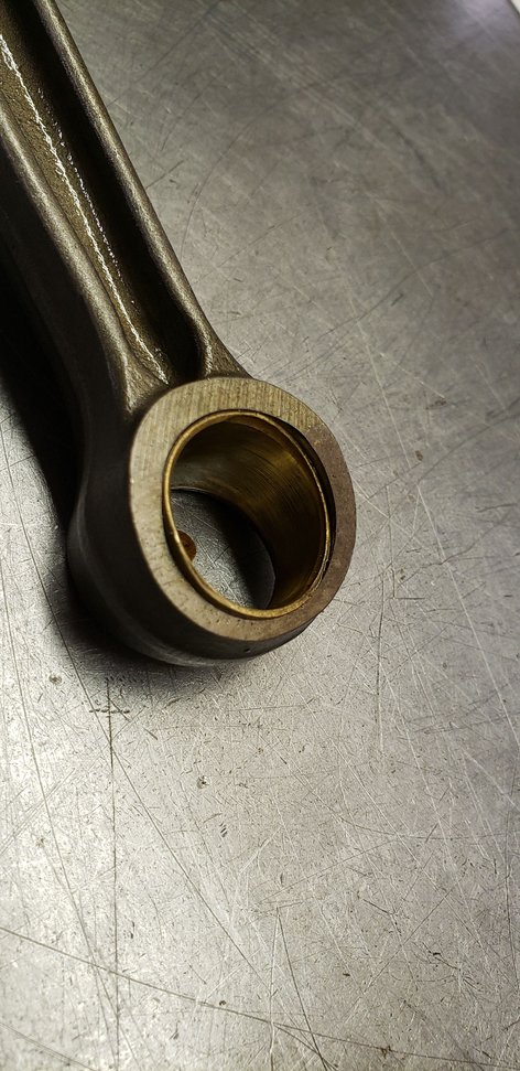

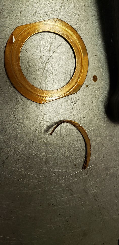

With everything you take your chances with some having odds better than others. You can have a bottom end failure with a compensator on a motor with a mild mod. My stock stage 2 with compensator had crank / con rod failure. Don't know what went wrong but here are some pics of the pieces. It was painfully expensive but the rebuilt motor runs great (so far). Independent mech / tech said it was a rare failure. Before the failure there was the odd banging nasty start. With the rebuild engine starts are very clean. Rebuild has the latest compensator (those things are a massive chunk of iron) with a trued / welded crank.
Arrow points to rub from fly wheel
spun wrist pin bushing
Thrust washers, one still there and remains of the other one.
